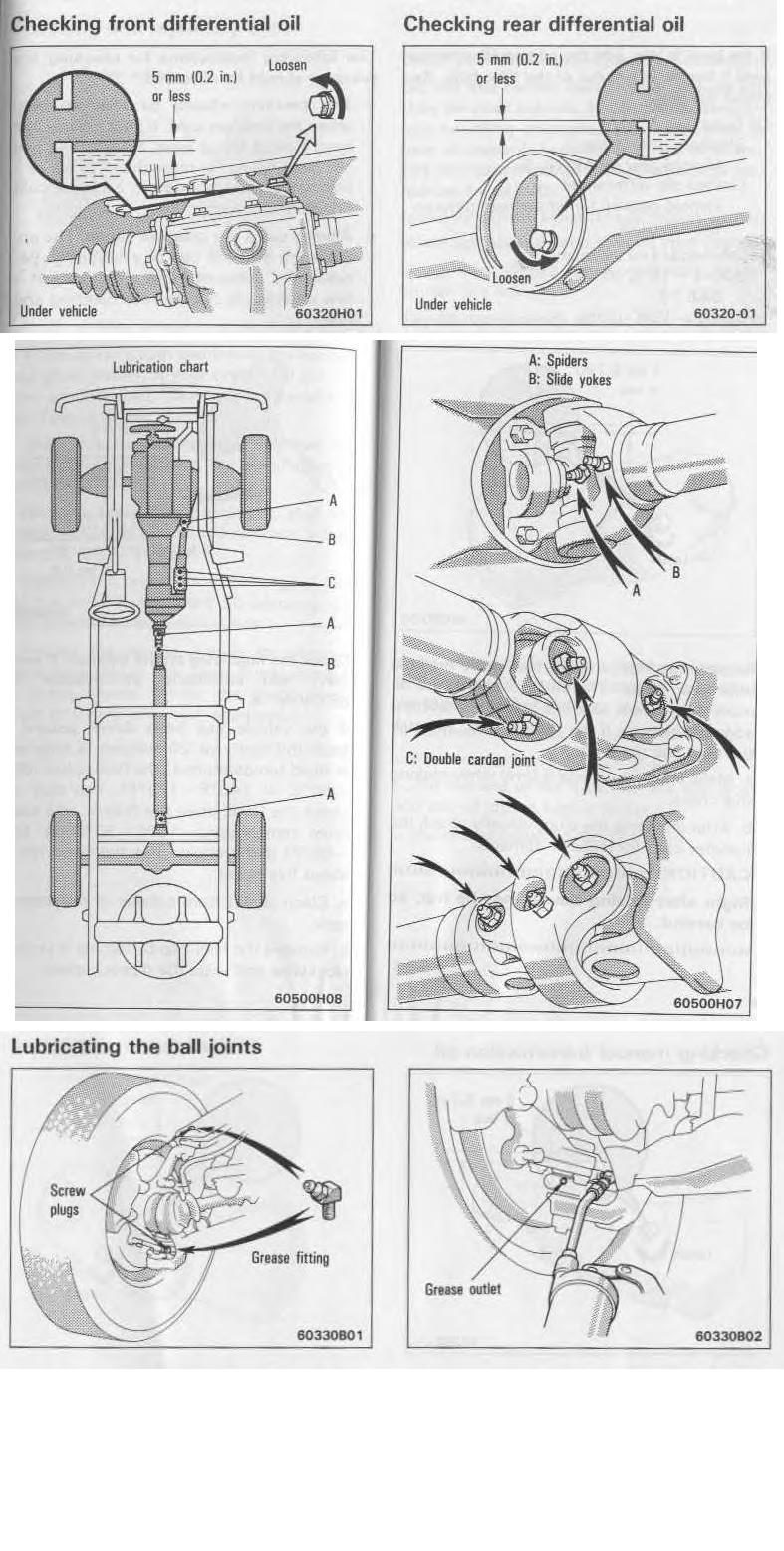

Hi Guys,
Where are the greasing points on the 3rd gen?
There doesnt seem to be any on the top and bottom of front suspension.
Not even blanking plugs.
Can you help?
