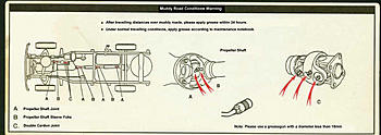

    there you go

          You only need to grease your prop shaft front & rear, there is nothing else with nipples, unless the misses needs a service aswell.
          Standard grease gun head fits them.

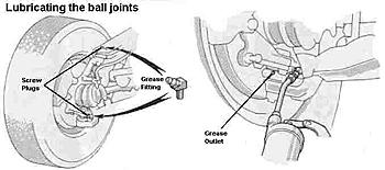

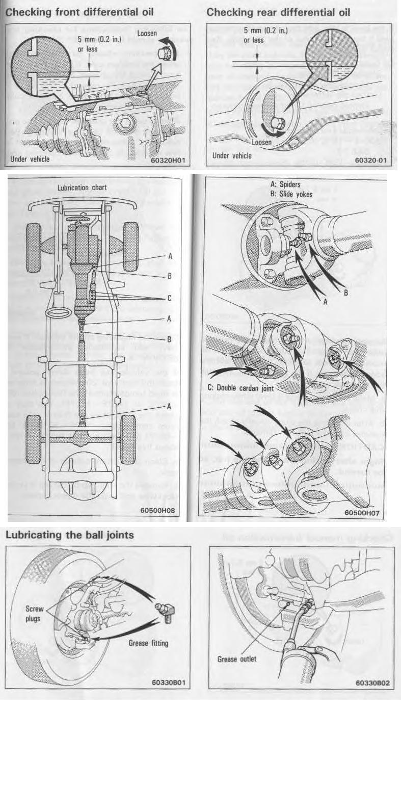

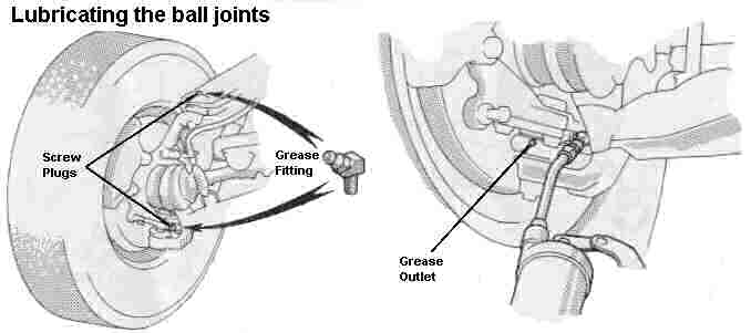

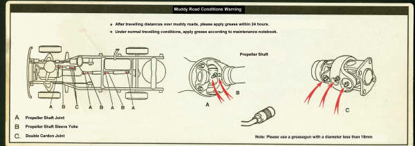

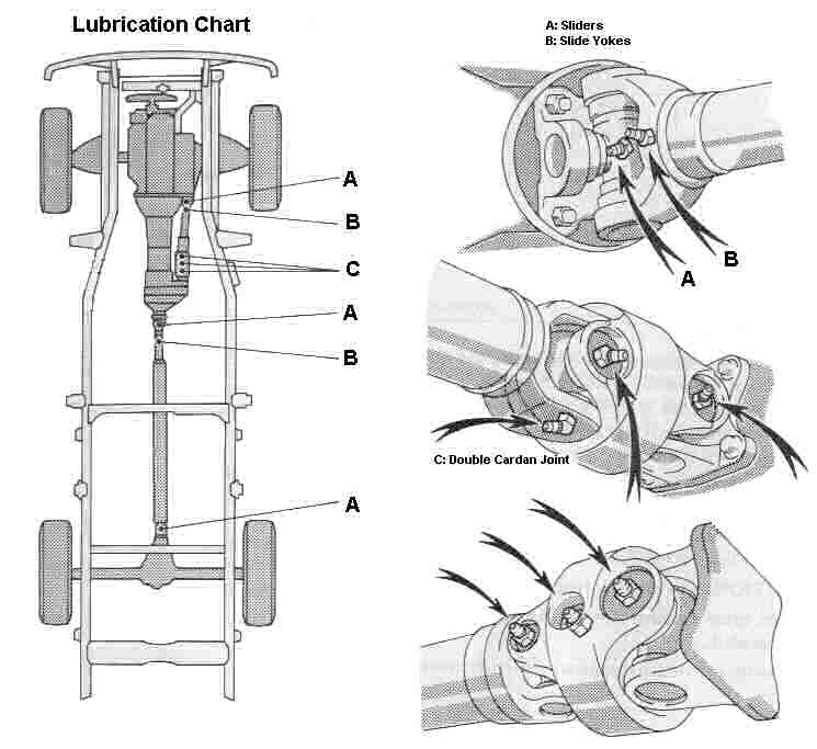

            Had a dig on my PC and found these, can't remember if they're for a 2nd or 3rd Gen tho....
              Nice, thanks very much for posting these up!
