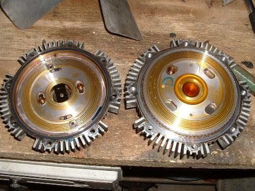

does anyone know wheir i can get the fluid for the engine cooling clutch
fan clutch
I'm sure Stevo will know - he overhauled my viscous clutch when I ordered the new cylinder head, and I believe he adjusted it so it works at a lower temperature to keep the car cooler - might be wise asking him what he did to it.Originally posted by cjpdoes anyone know wheir i can get the fluid for the engine cooling clutch
Toyota supply it. Check out this link - the part no is on there http://www.off-road.com/~estegall/te...fanclutch.htmlOriginally posted by cjpdoes anyone know wheir i can get the fluid for the engine cooling clutchRoger
THANKS ROGER FOR THE LINKOriginally posted by GamedawnToyota supply it. Check out this link - the part no is on there http://www.off-road.com/~estegall/te...fanclutch.html
or get silicon fluid from a model shop - as radiocontrolled cars have limited slip differentials these days!,
I got some bottles of it a while back - just get correct wt of the fluid. probably cheaper than toytoa parts counter. and it worked well in my fan clutch.
heres where i got it: http://www.gmmodels.co.uk/acatalog/Shock_Oils.html
cant remember how much was in each bottleLandcruiser Colorado
Sub. Forester
the silicone oil from model shops is for diffs in rc cars. it comes in 100ml bottles at around 5 quid a pop. trouble is it comes as 1000 or 10,000 weight and the fan needs 3000 wt... i make that 2 bottles of 1000wt and 1 of 10000wt making 3250 wt?it's in me shed, mate.
