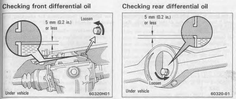

after a 15 mile road trip i was under surf to find where knocking was comming from(antiroll bar securing clamp snapped, so off to main dealers tuesday ) i notived rear diff housing was quite warm to touch is this normal or have i a major problem bruing, a little concerned as im pulling caravan down to mendips next week HELP
