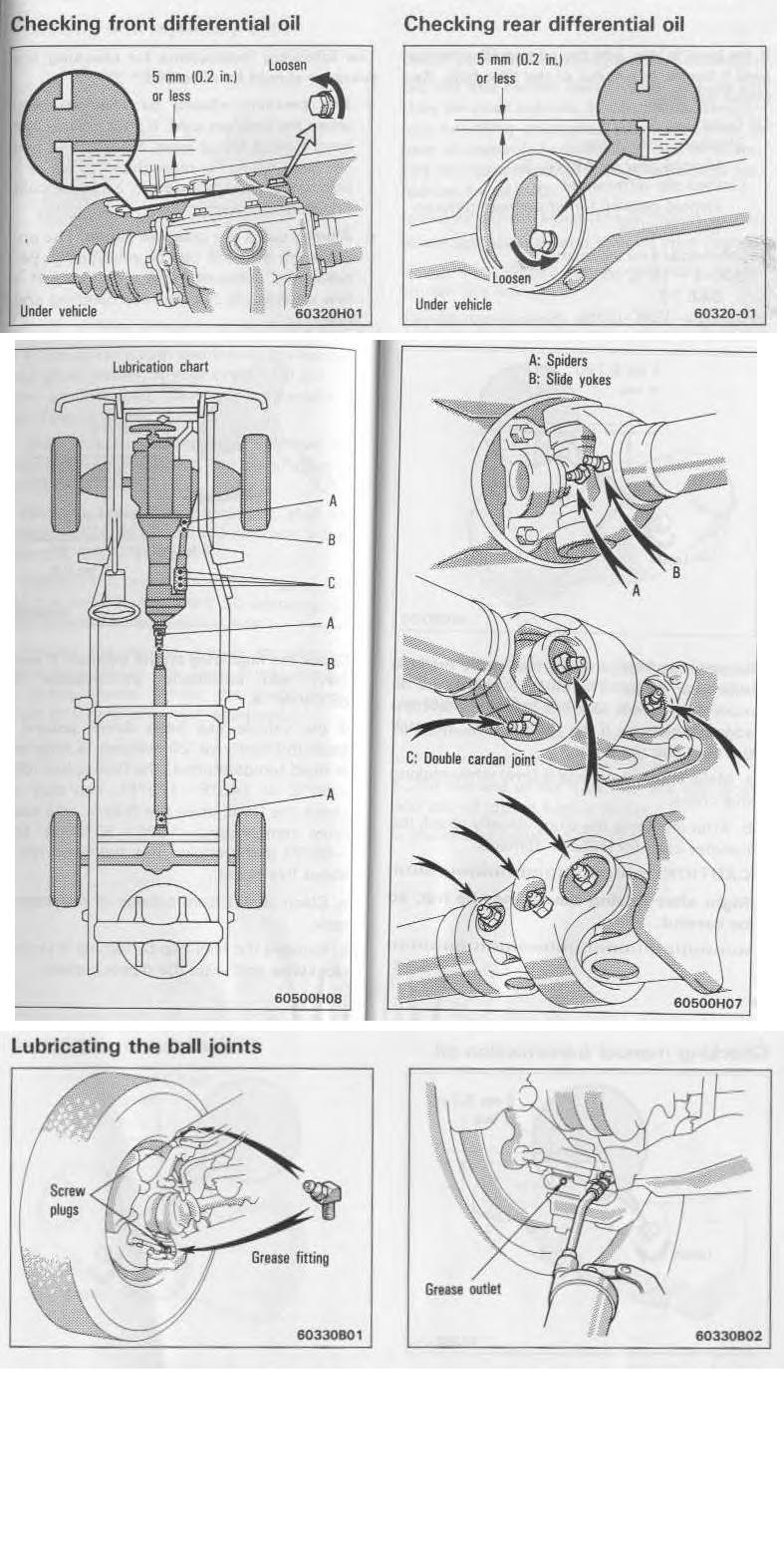

does anybody have any service info i.e pics detailed description i need to know where the sump plug is to drain the oil a pic would help also does anyone know how to change the fuel filter same as sump pics and details im probably being over cautious but i dont think you can be to prepared have found a good mechanic to do cambelt for £60 labour

Have a look through the FAQ for info or do a search for the Aussie Site, theres a techie page on there for different modelsGaz
Some of it is here....Originally posted by matthew coventrydoes anybody have any service info i.e pics detailed description i need to know where the sump plug is to drain the oil a pic would help also does anyone know how to change the fuel filter same as sump pics and details im probably being over cautious but i dont think you can be to prepared have found a good mechanic to do cambelt for £60 labour
http://www.yotasurf-online.co.uk/pub...hread.php?t=62
