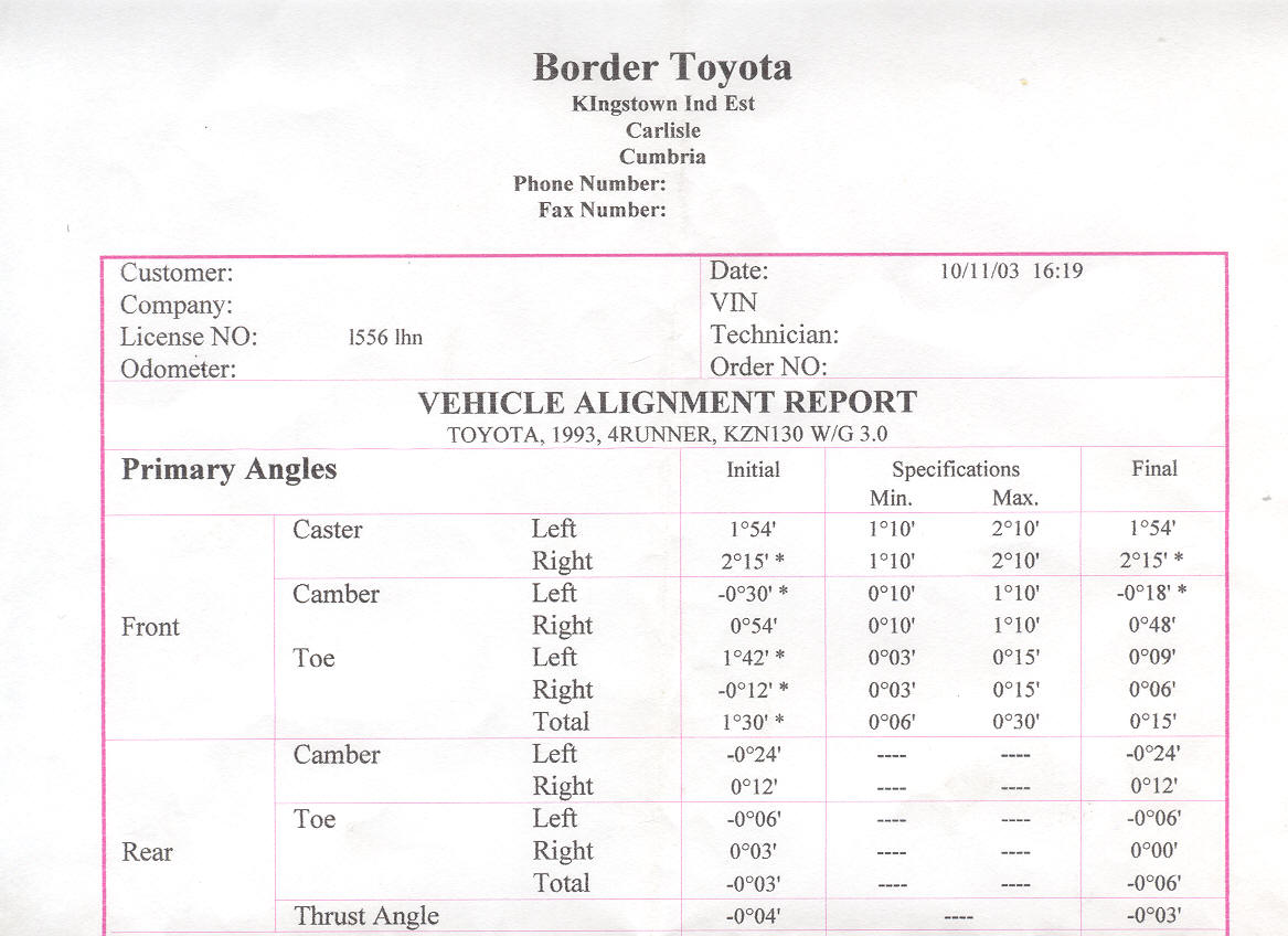

    Front Wheel Alignment
    The enclosures are 1.) Diagram of Steering Linkage
    2.) Wheel Alignment Specs (for KZN185 but I believe they are the same for the KZN130).
    I suspect adjustment of tracking is via the Tie Rod clamps instead of the more normal locknut and thread.
    Nil Illigitimi Carborundum
      just tell them to use 4Runner values.
