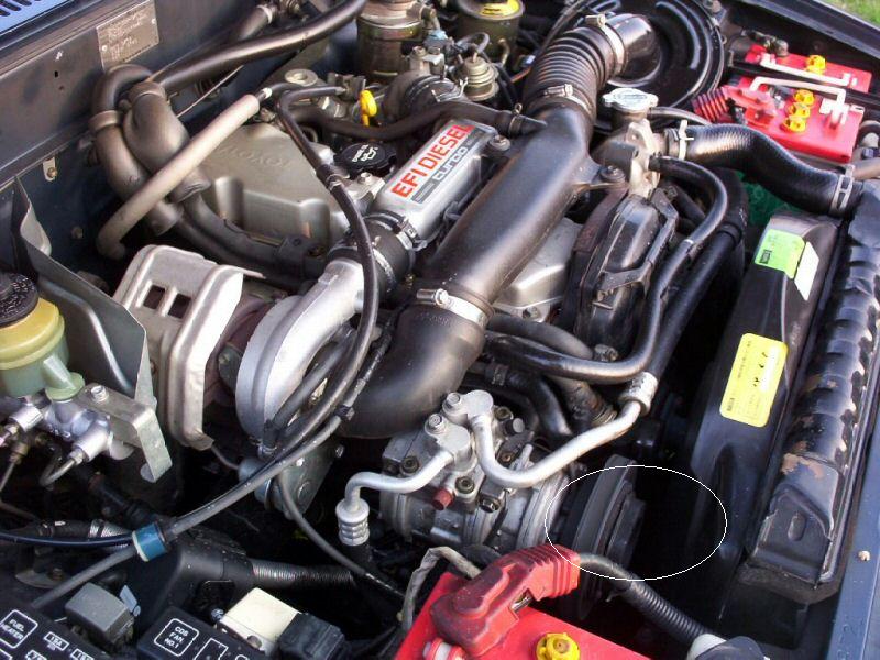

    When I press my air con button the light comes on but there is no change in engine tone and no cold air? (There is cold air just not air-conditioned cold air) all the levers are set to cold and everything looks ok! Ware do I start?

    When the aircon is switched on the wheel on the end of the pump should spin check this first
      That pulley spins all the time.There is a clutch mechanism which engages the pulley with the pump when button is pressed.There is also other things built into the air con system which will prevent this from working if low on gas.

        I thought the end spins seperatley when button is pressed
          The pulley with the belt spins all the time but the part in the middle doesn’t seem to spin whether the button is on or off. But it will turn by hand. Supposedly when I bought the car the air con had been re gassed.
          I’m not sure ware to start when it comes to air con has anyone got any ideas?

            The centre should spin when the button is pressed. check fuses relays etc.

                Post your results for more help as my aircon & electrical knowledge is a little vague
                  The aircon will stop working if the gas pressure drops too low. There is a sensor for this. If the a/c was recently charged then you probably have a leak. Could be damaged a/c rad or dry seals in the pump. It should be exercised weekly even in winter. A proper refrigeration engineer will have a sniffer to locate a leak (of course he'll have to refill it first ££££).

                            right I have checked all my fuses behind the glove box and all seem fine n dandy - the clutch for the AC doesnt kick in when I press the button but by what you guys are saying is if its low on gas It will not cut in regardless???
                            Tim
                              Yes, it will stop working if its low on gas, to preserve the pump.
                              Best way to check is put the heater on a little to get warmish air, then turn on the a/c - you should notice the change. It doesnt work as well when the air temperature is cold anyway. All to do with relative humidity - cold air = less water to extract. Someytimes refilling will work if the gas has just leaked out through lack of use. But it can also be due to damage to the a/c radiator.
