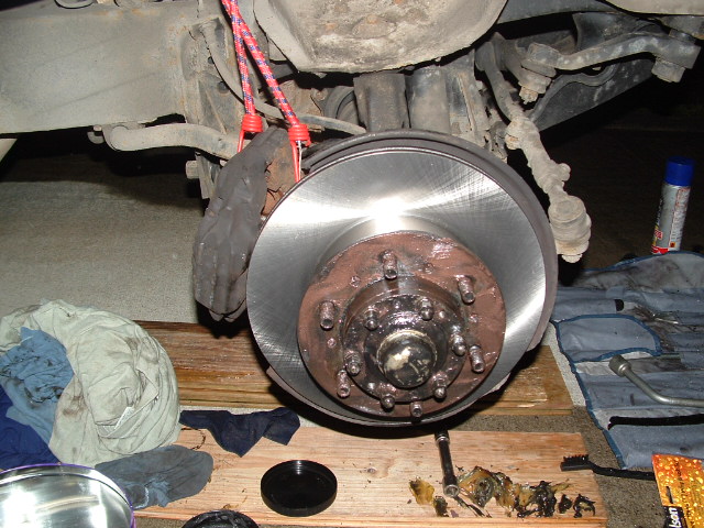

I put the Surf up on 2 axle stands and took off both wheels. I took out the two 17mm calliper mounting bolts and suspended the calliper with a bungee.

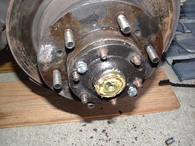

To remove the discs, I popped off the hub cap with a small flat blade screwdriver & a rubber hammer, undid & removed the 12mm bolt/washer from the end of the axle. Then I undid & removed the six 12mm dome head nuts from the hub cover. There’s a spring washer and a cone washer on each stud. I made sure not to lose them. I used two 8mm bolts to screw inwards, which pushes the hub cover off the hub. I cleaned all the old grease out and bent back the retaining washer lug. I don’t have a 54mm socket, so I used a chisel & hammer to free off the first 54mm nut. I took off the retaining washer and freed off the second 54mm nut the same way.

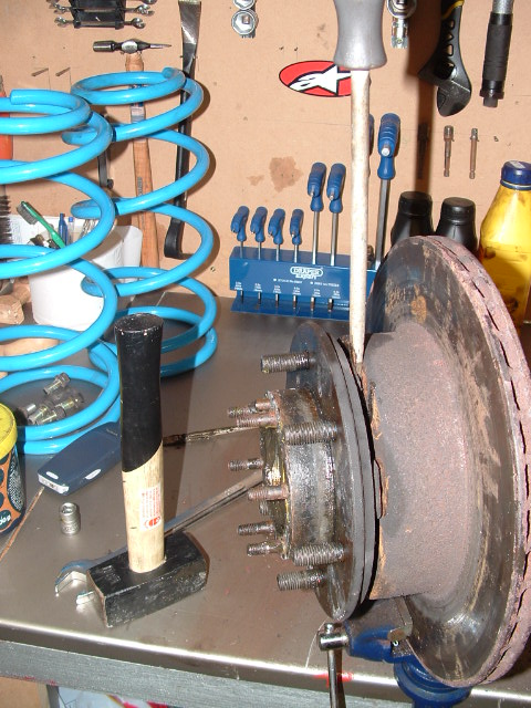

When I slid the hub off the axle, the outer bearing fell out. I took the hub/disc into my shed and undid the six 14mm bolts holding the disc & hub together. These were TIGHT. I hit the breaker bar sharply with a rubber hammer to break any seizing. All six came off ok.

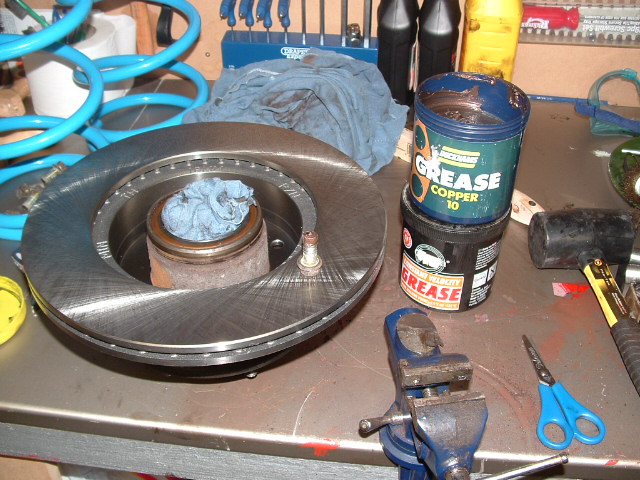

I put the disc in a sh1tty little vice and used an old large blade screwdriver with the same rubber hammer to separate the disc from the hub.
I used copper grease on the nuts when I fitted the new disc to the hub. I think I had read that the torque value for these nuts was 90lbft, but I’m confident they were tight enough before my torque wrench clicked.

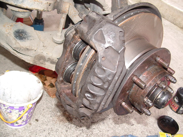

I had taken off the calipers to work on them, but decided that it’d be easier if I left them on the car, so I put them back on. I took out the retaining pins & clips and used the old pads & G-clamps to hold back all pistons but one – all 4 on one calliper and just 3 on the one I was working on. I pumped the pedal to push out whichever piston I was working on, then pushed it back in with a G-clamp. While it was out, I used brake cleaner & a toothbrush to clean it. I did this 3 or 4 times with each piston till they were all slipping out like they were buttered.
I then pushed them all out evenly and removed the caliper from the car so I could slip the new dust boots over the pistons. The best I could do to reduce brake fluid leaking from the line while the caliper was off was to push a match up into it... The boots seated quite easily in the groove in the piston, but getting them over the lip on the caliper was trickier. I had to trim 1-2mm off the new retaining rings with a snips – otherwise the ends were meeting and not having any spring action to actually retain the boots.
Putting the new pads in is easy enough – I put copper grease on the backs of the pads to reduce squeal/seizing. Then I bled all corners of the car. My 4 year old boy pumped the pedal while I shouted instructions to him as I released the bleed valves…

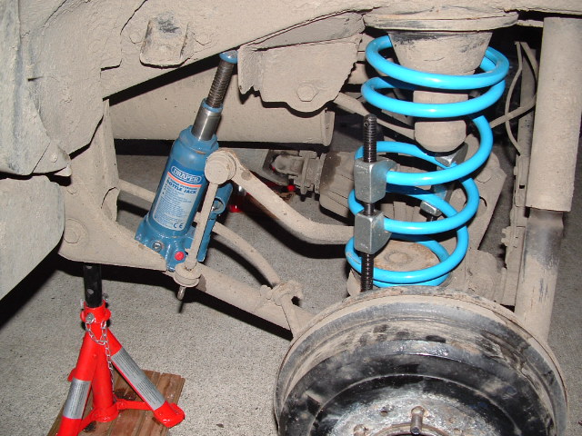

I jacked up the diff, put the axle stands beside the rear trailing arm mounts, then removed the jack from the diff. I removed both wheels, disconnected the top of the sway bar drop links, the lower damper mounts, and the two brake line brackets on rear diff.
I gave the old springs a few bangs with a rubber hammer to help free them off. I used compressors on the old springs and stood on the drums. The old springs came away quite easily. I removed the compressors and used them on the new springs. The first went in fairly easily, but I did think that the diameter of the lower coil appeared slightly smaller than that of the seat. I rotated the spring till it was seated properly, and removed the compressors.
I did more or less on the other side, except for, because of the new spring now in the other side, I couldn’t push the axle down enough to get the compressed new spring in, so I used my bottle jack between the trailing arm and the chassis – worked a treat.
