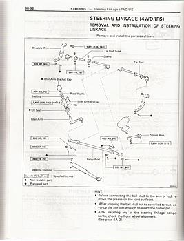

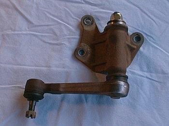

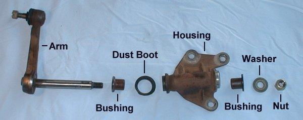

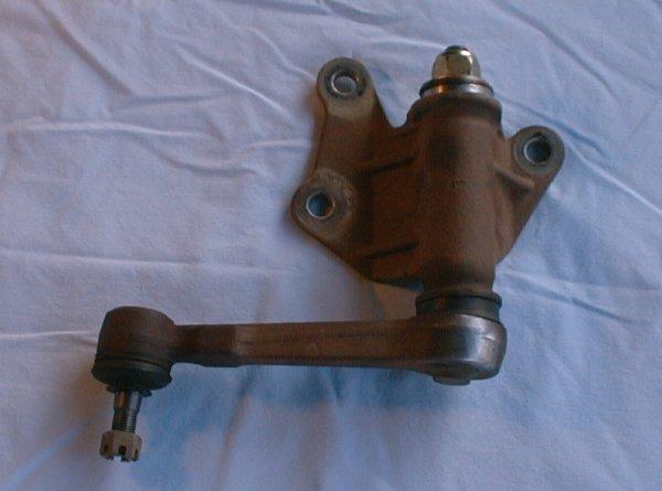

            JACK the front up & manually move the wheels side to side & watch the balljoints. Ive added some pics which may help.

                  Worth checking the idler arm though, we just discovered Lindas trucks one is way looser than others I've changed for people, but its not causing any problems yet but a repair kit is now winging its way to the homestead.
                    the garage said there is a little play in one of the idler arms but nothing substantial, the mot is due soon so i will do all the bad stuff then
