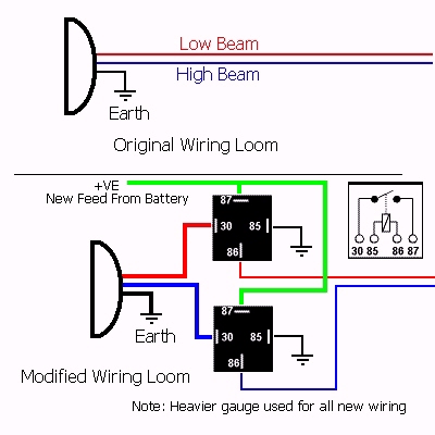

      I've had some pm's asking for more info on how to modify the wiring loom, hope this drawing helps....
      This mod ideally requires 4 relays, one each for high and low beams for each headlamp. You can get away with 2 using one for each beam connected to both lamps, but this way if you get a failure you will loose both lamps. 4 is best.
      You will also require heavier wiring and new connectors for the back of the bulbs. If you can't source these locally, www.vehicle-wiring-products.co.uk/ looks good.
      Note: I've forgotten to put it in the drawing, but its imperative that you use either a fused relay, or fit an appropriate fuse in the line bringing the new live feed to the relay. This new line (in green) should come directly from the positive terminal of the battery and the fuse should be located as close to the battery as practical.

        Morr,
        Nicely done... So, what minimum gauge wire should that be? and what should the current rating on the relays be?
        Say 60amp capacity on the wiring and 30amps on the relays... obviously different draws on different bulbs... etc...

                        OK, Gentlefolk.
                        I am going to build myself one of these.
                        And make a kit for the 2nd Gen Surfs amongst us.
                        Anyone want one? PM me.
                        AndyL

                          Morr,
                          I finally have a loom in my hand but am having major problems... overheated the existing loom a couple of times, with no major damage.
                          I am getting really confused.
                          H4 Bulb.
                          Looking at the back of the bulb.
                          Common - left hand connector
                          High Beam - Top connector
                          Low Beam - right hand connector
                          (I am sure these are wrong... but cannot find a reference anywhere as to what the connections on the bulb should be)
                          If you take the common and top connector on the OEM Loom to energise the coil on a relay, I can then use the relay to pump positive to the top connector direct from the battery, and Negative to the common (left hand) connector direct from the battery. The bulb shouldn't mind whether it is switched on either side of the element?
                          Or should I wire the bulb the same way, ie. live all the time to the common connector and switch in the negative with the relay...?
                          Am I missing something?
                            Use a volt meter to determine what powers what on the wiring loom, then wire it as per Maurice diagram and it should work.
                            Fuse each pair of relays with a 20amp fuse

                            Maurice, no offence meant but have you got the wiring round the wrong way???
                            I've got mine wired like this
                            30 = +ve from battery (via fuse)
                            85 = Earth
                            86 = Feed from existing wiring loom
                            87 = Feed to bulb

                              I have a problem with this.
                              The headlamp loom runs switched earth, not switched positive.
                              So the common connector on the bulb is live, and the loom switches the earth in, making the circuit.
                              So if that very circuit energises the coil in the relay, you should be able to switch positive to the bulb, by earthing the common terminal on the bulb.
                              (same as the side lamps and indicators incidentally)
                              That bit is fairly straight forward.
                              Two things.
                              1) the circuit is designed to see a resistance, the bulb... hotter/brighter it gets the higher the resistance... all we will have is a coil in the relay...
                              Do we need a resitor in that circuit...?
                              2) which terminal is supposed to be the common terminal?
