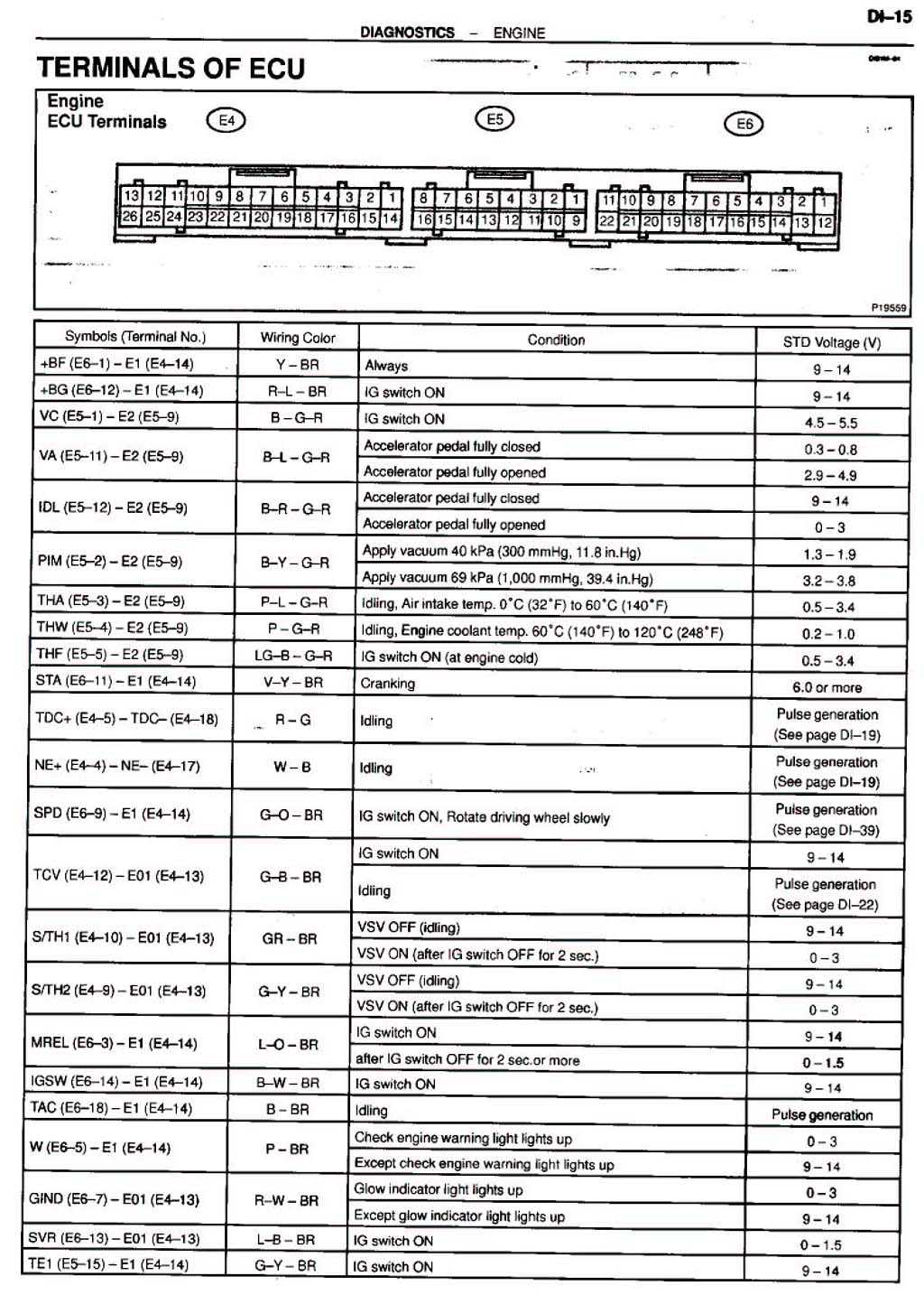

    Where can I get hold of the ECU pin out / wiring diagram for a KZN130?
    The ecu has 26-16-12 pins
    Here you go. Welcome to the forum by the way
    Rich.
    If life's an uphill struggle then downhill from now on can't be that bad?!
      Thanks, but this is not going to work, that is the ECU wiring from an KZN165 and later. The ecu pinout on KZN165 and later is (26-16-22) pins.
      I am looking for one with (26-16-12) pins.
        This is from the 1KZ-TE 3.0 Engine Manual which is the engine in my KZN130.
        Edit: No actually you are right, just looked again and it is for the later KZN165! Sorry, cant help.

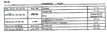

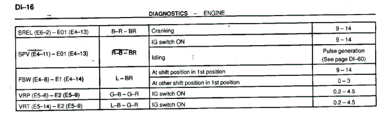

          Hello!
          I'm looking wiring diagram for this engine. Could anybody share it?
