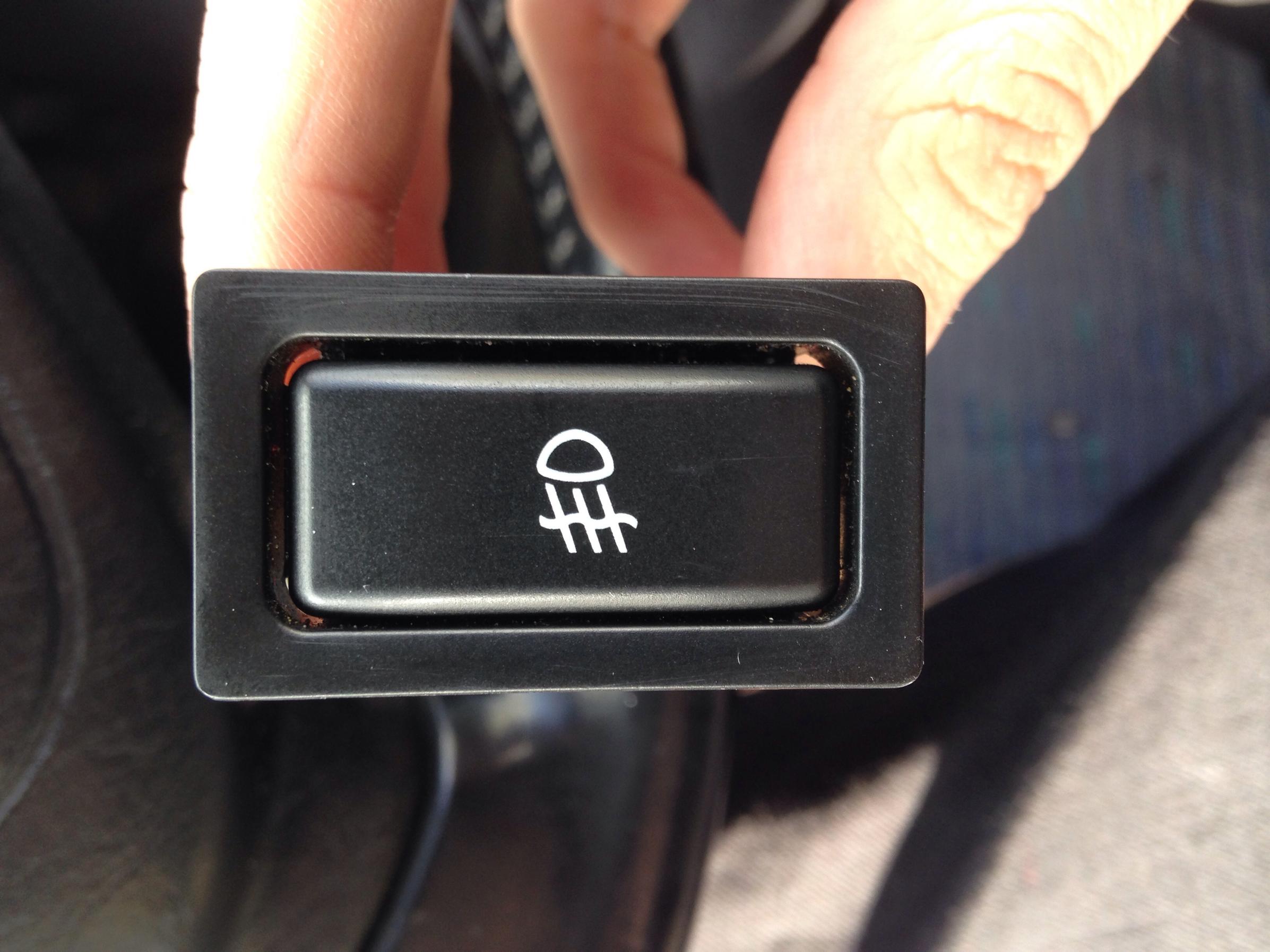

      Hi, thanks for the quick response! I have attached a picture of the switch, I know it has 5 pins but have no idea at all how I would use a third party wiring loom to encorporated this.

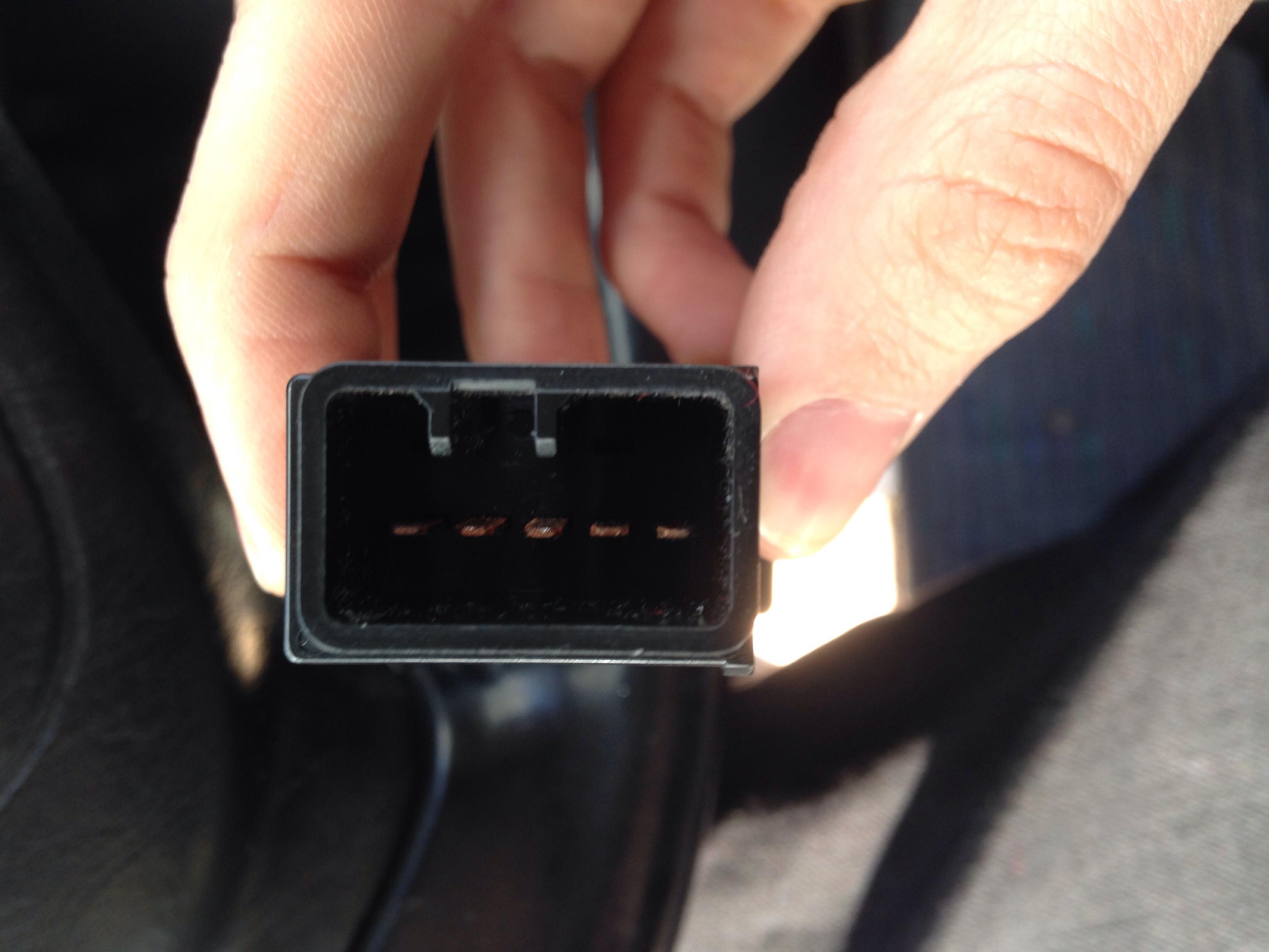

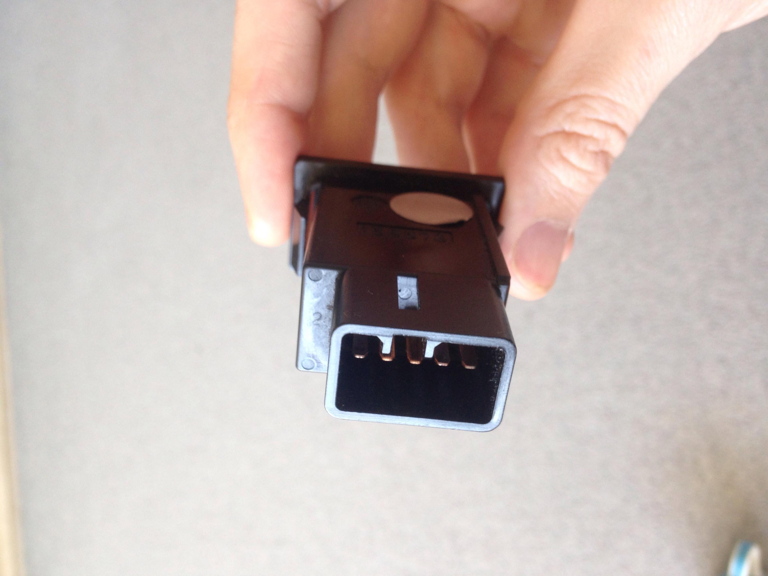

        What was its original function? And need photo of front and clearer one of pins if poss
          Hi Growler, sorry for the late reply. The original function was for fog lights (see attatched pic). I have also attatched a couple more pics. I have found the prongs that complete a circuit today and I'm thinking about just connecting some spade connectors to it? Your thoughts....
              So long as you have identified the two pins that are controlled by the action of the switch so it makes/breaks the live feed that should work fine.
              One or possibly two of the other pins would be for the internal illumination of the switch so it can be found in the dark, which give fifth pin as an option for a ground connection for the illumination circuit.
              Just be sure to test all is working ok and feed the lamps via a relay that the switch controls.
