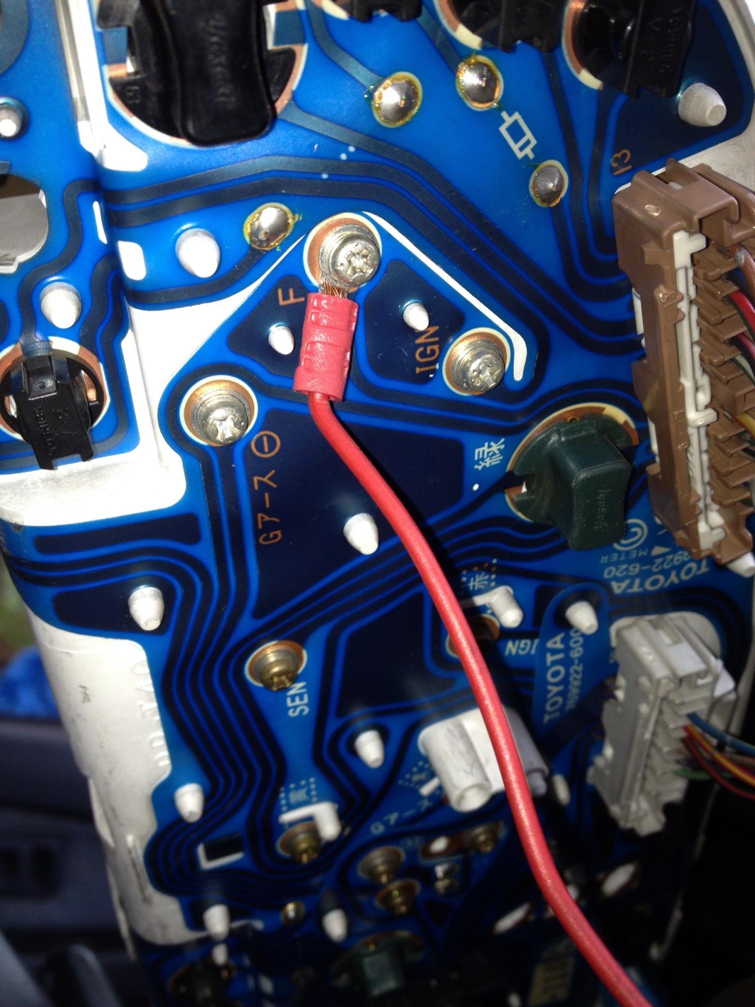

        I took the dash out to reset the timing belt light and found a red wire, connected to nothing, tagged onto the back of the PCB at a point marked "F"
        Any ideas? Is F the fuel gauge feed?
        Thanks in advance
          To me it's sounds like a faulty ignition switch barrel, also that red wire looks very aftermarket maybe something to do with your immobiliser, def not factory fit.
