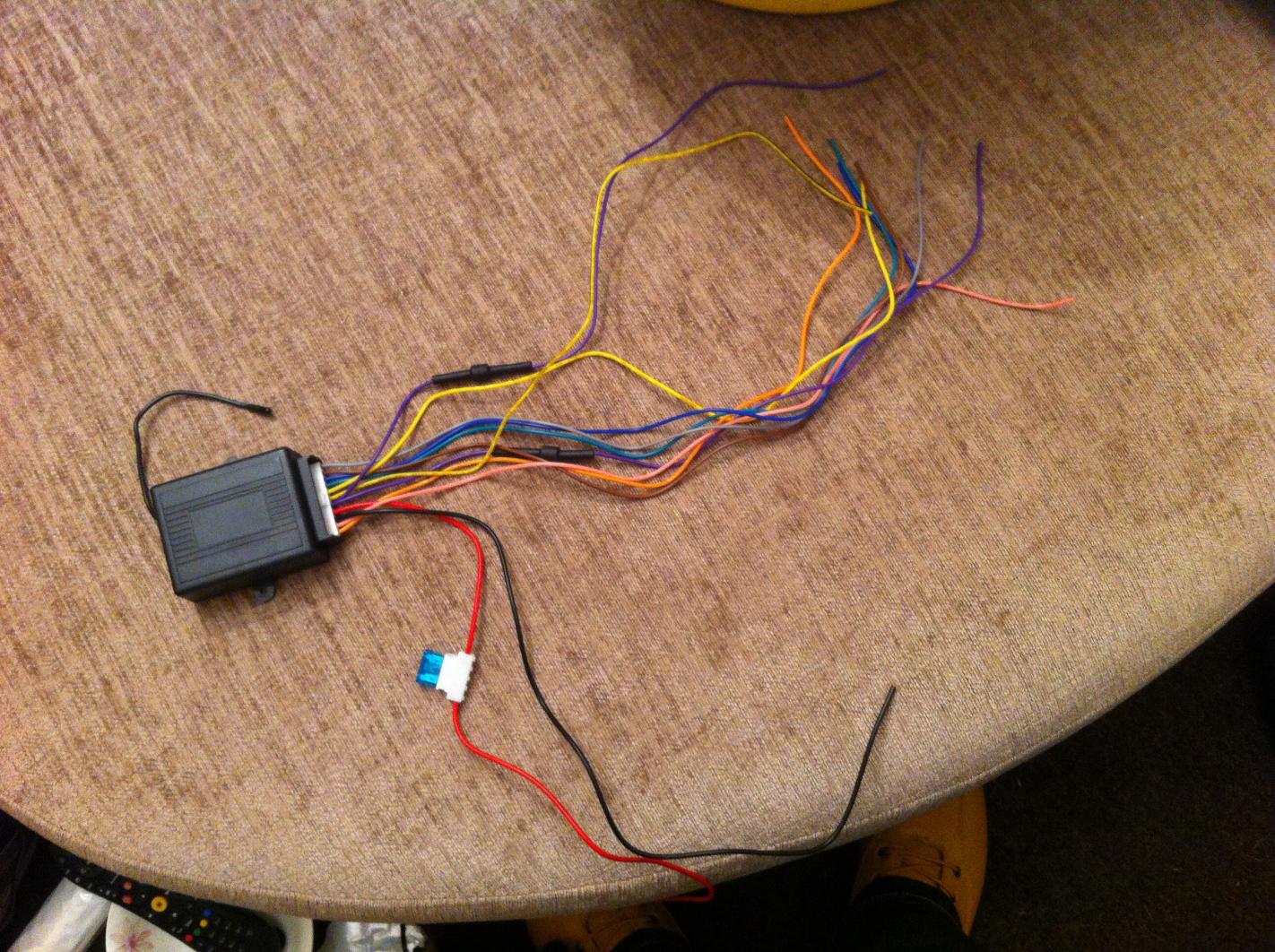

    Hi folks
    Jus got a remote locking kit from fleabay and read through the poss about what wires I need from relay etc in the drivers kick panel. But, what wires from this do I need to connect, I'm guessing the fused red is the positive and black is negative but what about the rest of the spaghetti rainbow?
    Any ideas?
