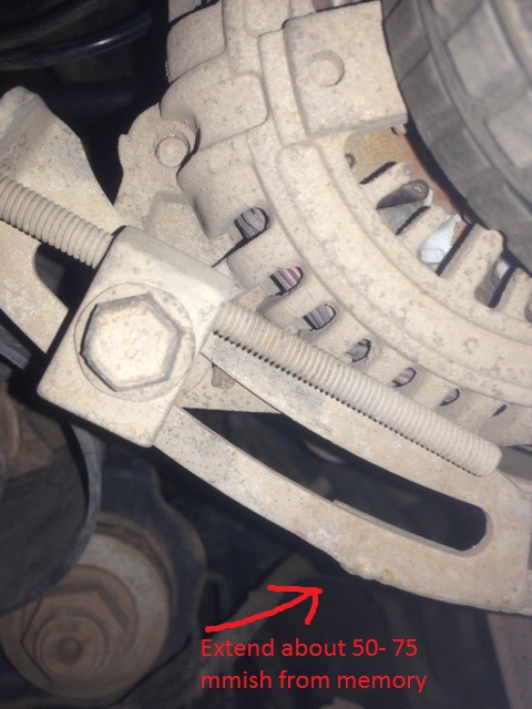

        yes, Ive done it
        I didn't get pics while doing it but these are the one I could try and get
        If your mechanically minded and and have access to a welder.
        The only think you need to do it extend that adjustment bracket 50 to 75mm from memory. The plugs are all the same

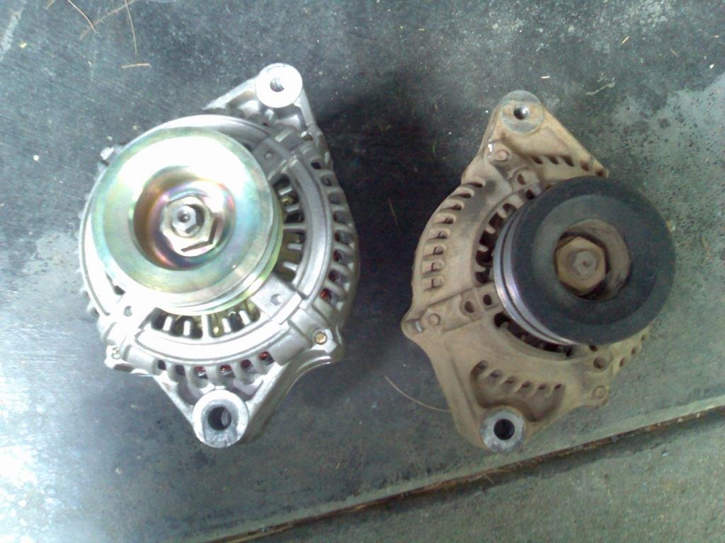

          This is on my 'to do' list - I remember NiftyNev giving me the info but I lost it on my old pc. Still have the pic of the 2 alts side by side.

                      Can't remember which one I worked it out to be...it's all about plugs, bracket and pulley matching.

                          An alternator from a 1hz will fit a kzn130 surf
                          It won't work on a ln130 and not sure on the knz185
