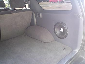

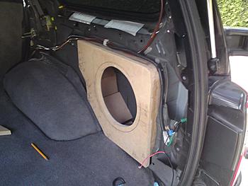

Pretty rubbish pics, but a but back I built a flush sub enclosure for the truck.
I didn't want massive banging bass, just to thicken out the sound a bit, but without losing any boot space, so I can still deploy my "truckbedz" mattress.
The trim part could have been a little better, as the original cubby hole had to me removed (would be easier to make a neater job on a facelift bit of trim)
It doesn't look much, but it was a fair effort getting the correct volume for the sealed enclosure in that small gap, and fitting an amp too.
I thought I'd share it with you all anyway!
There is a cover on the way... it just hasn't been delivered yet
My original plan was to recess it slightly, so I could make a cover and trim it in grey cloth that was flush with the trim, but there is simply not enough depth in the rear wong to get it right.
