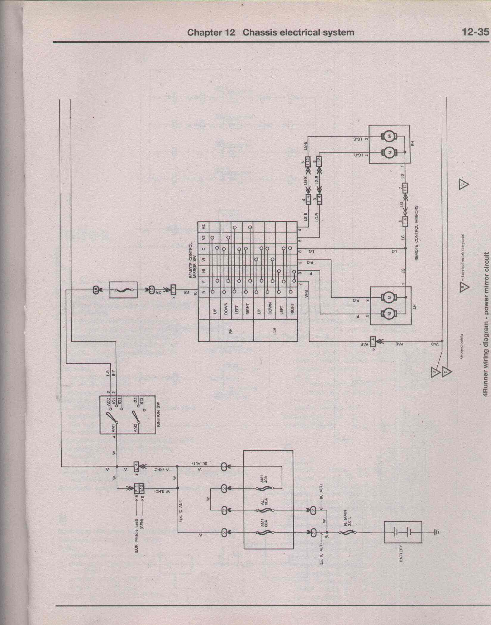

    Anyone out there with a wiring diagram for the electric mirrors on a 1990 2.4Td SSR ltd, 2nd gen. Where can I get a new control unit (mounted in drivers door arm rest)?

      i have wiring diagram
      Hey guys was looking through a gregorys automotive manual for 2wd and 4wd hilux 1988-1995 and found wiring diagrams for mirror.will try to post it asap.
        Hope you can see this, if not will do it again tonight.
