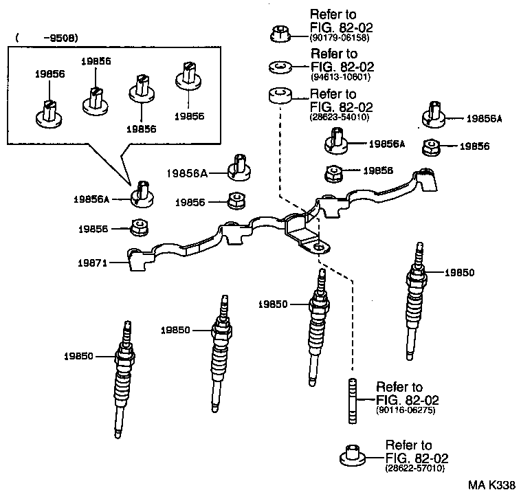

    hi all i recently went and changed my glow plugs on my 2.4 td surf 1990 but i have forgotten how to put the the connecting bar and wire and washers back i have put the bar on just need to know how all the washers etc go back on please help a pic would be helpfull to many thanks
    here
    This is from the bottom to the top
    Blue spacer (raised centre/post)
    Wiring connections
    Black spacer
    Washer
    Nut.

      thanks for that great help
