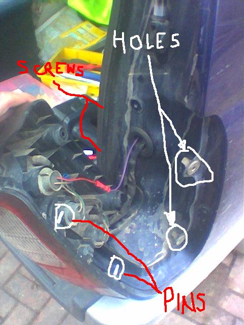

    dunno if yours is the same, but mine you open the tailgate and there's 2 screws hod the cluster in, undo them and knock the cluster to the side and it pops out... the little pins are quite tight in the hole so sometimes a good clout is needed... just don't break it!
    that's on a 3rd gen (up and over tailgate)... yours could be either being a '95... would imagine 2nd gen is similar
    oh, and the bulb holders twist and pull out
