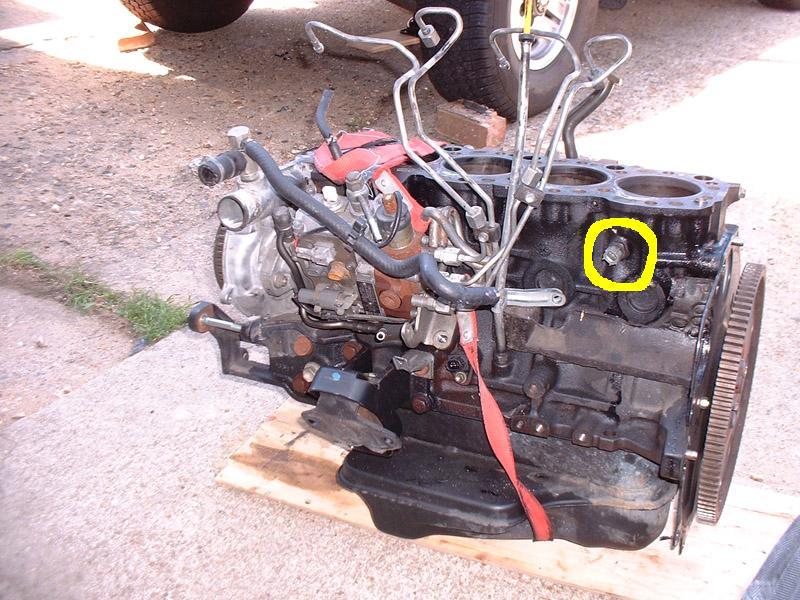

                  Hard to get at.
                  This is what I think your looking for.
                  Rubblebags (Geoff).
                    Thanks Geoff
                    Will check that out.Not where others have said it is.
                    Neville

                      I have now changed the correct temp sensor and, at the moment, no more red engine fault light!
