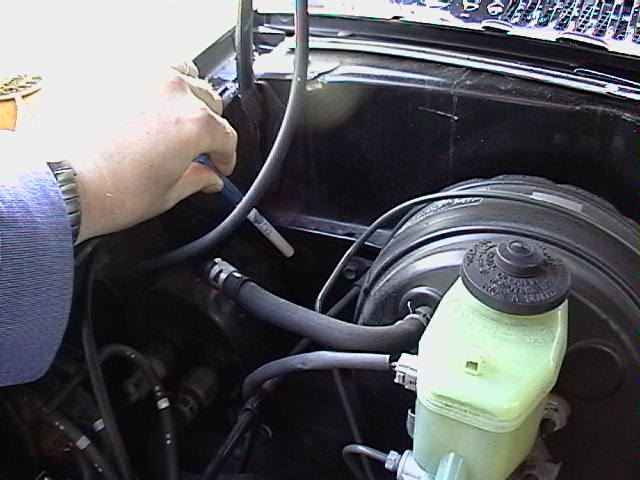

    Hi!
    How do you get wiring from the engine compartment to the dash?
    Have installed 2 new driving lights and I am baffled where to feed the wiring through to connect the switch at the dash!
    Usually it is a "gromit" etc but where the hell is it?
    Please help!
    A picture would be very much appreciated!
    Later!
    hellmett
    Hi, a friend wired up my fog light yesterday and he used the gromet just to the left of the servo, I've tried to highlight it with a pen on the pic.
    Regards, Damian.

        Hi if you look behind the drivers side battery, there is a cluster of wires you should find a "WHITE" male plastic plug use this as your feed as it goes to your centre console. if you get the right switch you can just plug in and "BOB,S" your uncle.
