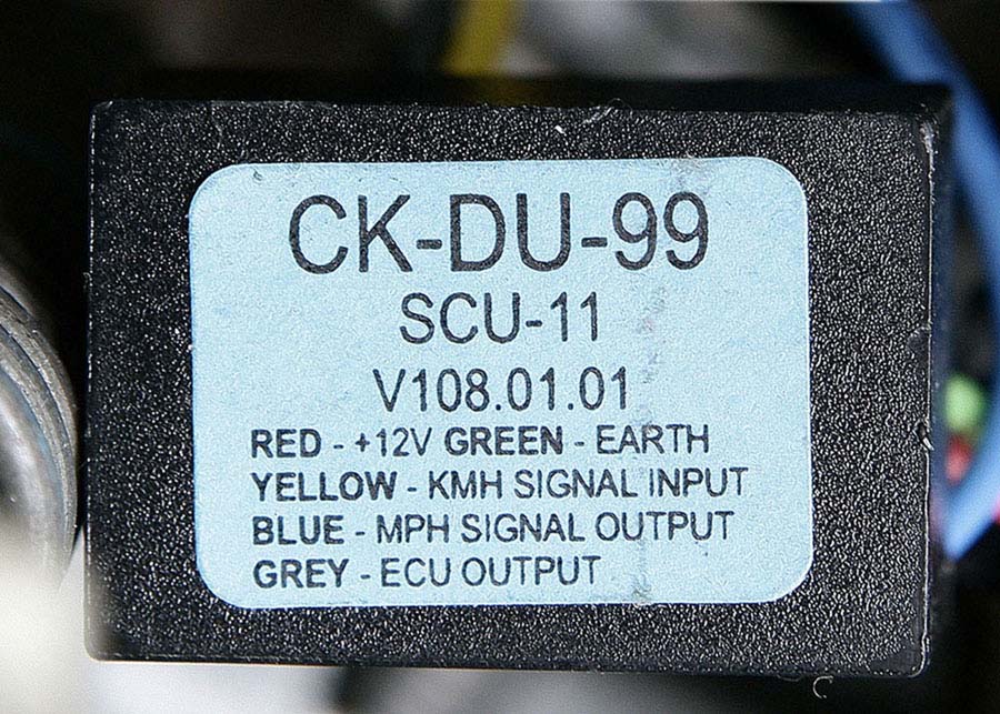

            I think I may have solved the mystery of the wires. They seem to be added to convert the speedo reading from KPH to MPH. I've attached a photo of the block that these wires are connected to. Cheers y'all, S
              Yup, reconnected the two wires and the speedo is working again. Every day's a day at school. Now.....back to the temp gauge.
