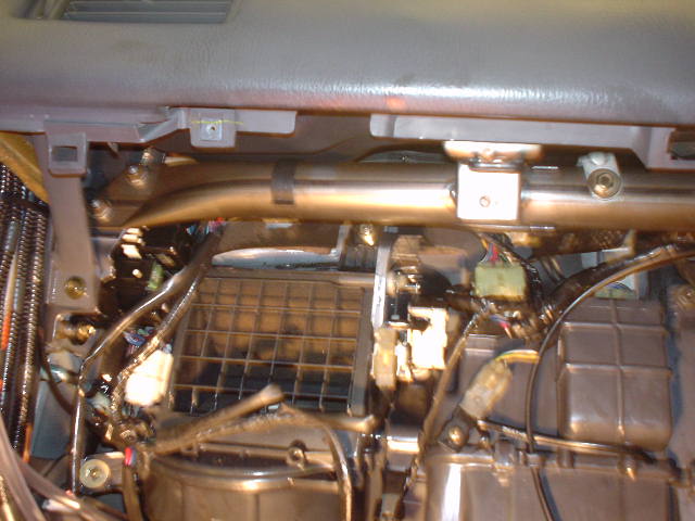

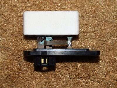

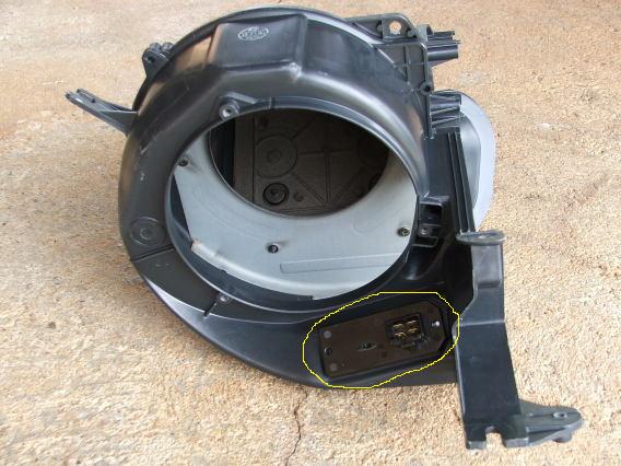

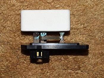

    Can't remember exactly where the answers are but ther here on the Forum somewhere, do a search for Heater blower/ Controls ... See below
    Quote:
    Originally Posted by TonyN
    Nah, its behind the glove box, I think it faces out. The one I took of my breaker for Jess can out easy, but the blower unit was already loose, and I cant remember how it sat in the car. But I don't think its any bother.
    Quote:
    Its the unit closest to the N/S of the car, the next one is the aircon unit, then the heater matrix. But I think you can get the resistors out without removing the blower unit. Look for where the loom goes into it.
    See also "Intermutant Heater Fan post of 4th February 2006" + pics

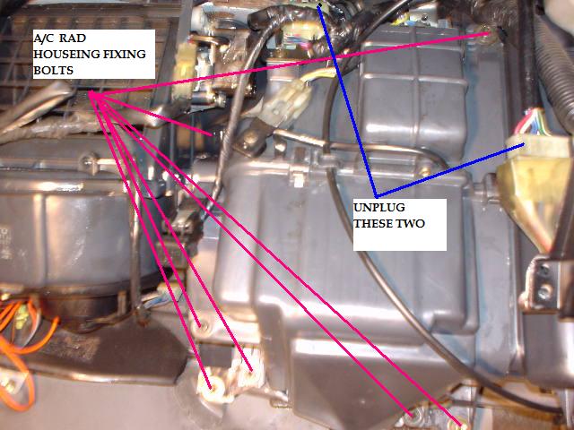

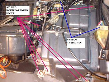

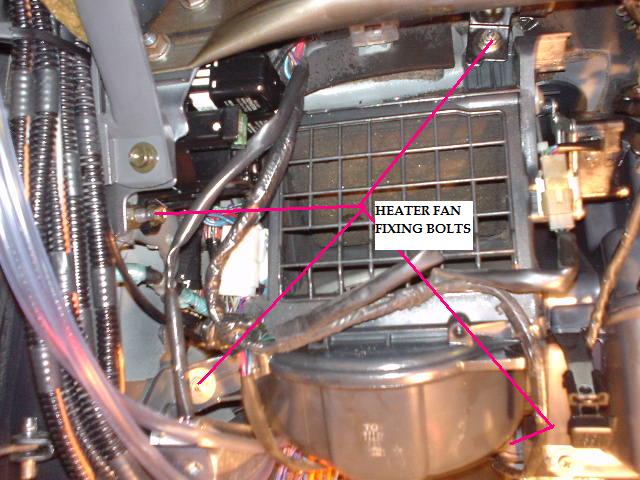

      Hello Mike and welcome, assumeing your import's right hand drive like ours the heater fan is behind the glove box on the left hand side footwell, here's some some pics of whats behind there, the arrow'd bit is the air con cooler rad, fan assembly is to the left, mine's the same as your's, even after a dam good flushing it still dont get very hot, and at lower setting the fan is useless,
      i'd check it's working first then that there's no blockage on the hoses, is it's all ok you'll just have to use high setting to get a decent demist
      have you disconnected the heater hoses and flushed them both ways with the house mains hosepipe?, mine was badly blocked with red gunge and took some clearing, especially the rear heater matrix, (flush that seperatly)
