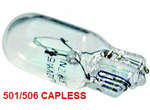

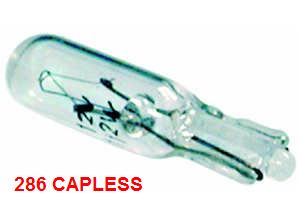

If the switch isn't working at all then without a shadow of doubt you have a blown bulb which will need replaced.
However, as a bulb gets older (in most cases 15 years it well past their lifespan!) it will very often get dimmer so LET'S REPLACE AND CLEAN THEM ALL while we are at it shall we?
You can get the replacements here:-
http://www.maplin.co.uk/Module.aspx?...=1955&doy=20m1
The code is BT43W
N.B. Make sure you get the 12V ones!
OK so far?
Right!
So we have our new bulbs, what do we do with them?
The first thing you will notice is that the new bulbs will be smaller than the old ones, don't worry they are the same power and will do their job very nicely!
When I removed my switches I found that their were 2 types of bulbs, the ones we can replace with the new ones directly and smaller LED types.
Removing the old bulbs and replacing with the new ones is a DODDLE!
Turn the grey bulb holder anti clockwise with a small screwdriver and it will fall out!
The bulb is held in by the 2 wire tails you can see, fiddle around and they will come out no problems!
To put the new ones in just do the reverse, put the two wire tails through the 2 holes, then wrap them around the tabs, no need to trim as the more you wrap around the better contact you make on the elements!
Remember to clean the little elements on the switch as will so as to make good contact with the wire tails, I used a small screwdriver to scratch the surfaces clean and shiney.
