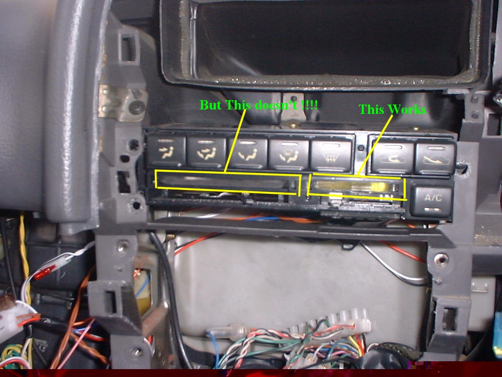

Can anyone out there tell me if the Heater Control Panel has access to allow the replacement of illumination bulbs, the individual switches remain illuminated but the Icons aren,t, i have attempted to locate a bulb replacement point but could not find one - ANY IDEA's?

Did it the other week, its daunting, but not particually difficult, the whole lower dash has gotta come out, and the panel over the dash clocks.
drop the radio out to reach the control cables.
Then unclip the control cables, and plugs and wiggle it out
The bulbs are right in the heater control, its needs to come out to get at them.
They are available at local car shops, but I had to bend the tabs a little to get them to work, check before refitting as its a pain to have to do it all again! (I know!!!)
I'd replace them both, as you don't wanna be doing it to often!!!
Ohhhhhh is this on the 1990 because if you pull the air con switch out, pull off the slider control knobs, front of the heater panel then comes off and you can get to the bulbsOriginally posted by TonyNDid it the other week, its daunting, but not particually difficult, the whole lower dash has gotta come out, and the panel over the dash clocks.
