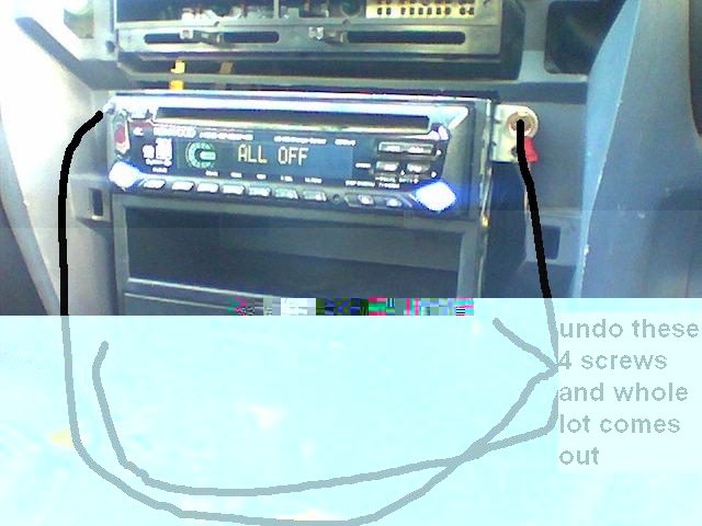

          halfords, cd player & cubby box, universal type as in photo

              "halfords, cd player & cubby box, universal type as in photo"
              Gemini will that box hold my head unit up or is there a whole facia surround and does my standard Kenwood metal cage hold in place with just that box below it ?? got to ask before I start stripping that dash ?

                The Standard bracket is a double DIN size with loads of holes in to mount the head unit and the cubby box. A lot of the Surfs come into the country with 2 single din units in, top holes mount the head unit and bottom holes mount the cubby box, no mods needed, just put the screws in and put it back together. The only thing on some Stereos is that their facias foul the console / radio surround and sometimes you need to do some trimming.
                  Nice one Andy, does the halfords type universal cubby box need to have holes in the sides to fix the mounting brackets into, and also if heard talk of a factory fitted amp that some surfs have how do I tell if I have one ?
                    Easy
                    m8 its easy go halfords but universal pocket and wiring harness thats all you need the pocket comes with the side connectors to fit the cage wich double din comes out of all really easy and when you take it apart you will see i done mine complete in under an hour and looks spot on

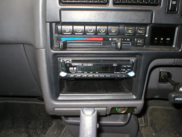

                      Nice one guys got it all done this morning looks and works great, took a couple of hours but well worth it..
                      Thanks again everyone
                        won't want a pic of how to get it out then?
                          lol yeah one prob is cant get that plastic surround that my Kenwood came with on now its fitted in ????
                          bugger
                            bugger
                            nah, but you don't need it as that's just to cover the edges of the cage.
                            the kenwood should fit quite nicely into the dash slot.
