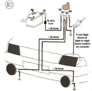

whilst looking at my water today i noticed this bit of wireing by the previous owner!
i have no idea and he seems to have disconected the plug from the "black box" as you can see in the pics
what has he done??
p.s. there are front fog lights he has put on the car has he butchered to put them on?
cheers in advance
