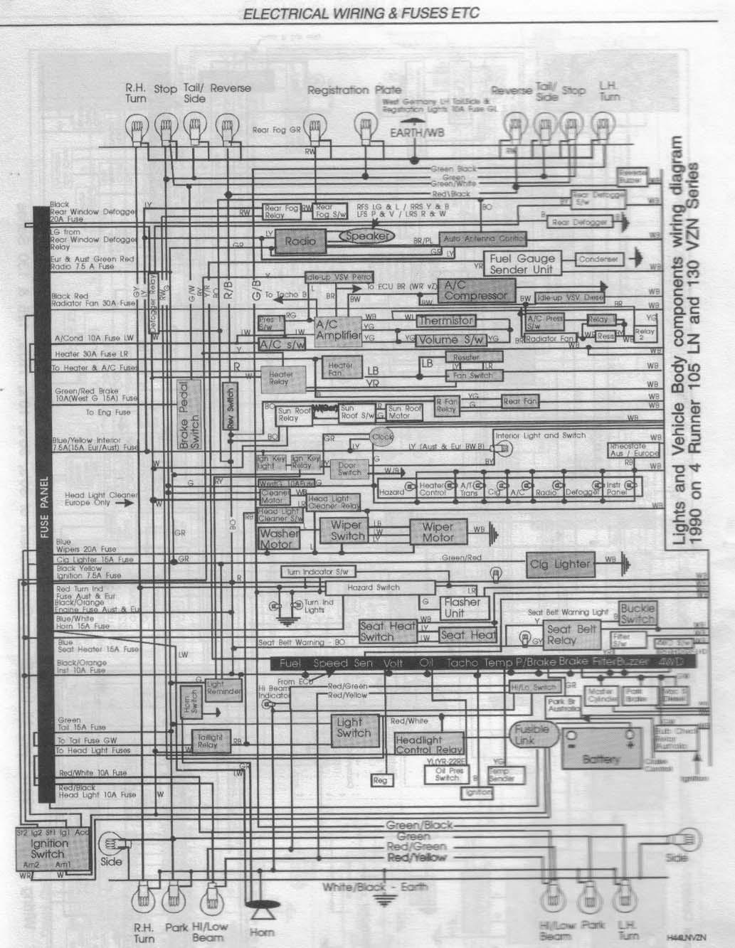

    This any good to you:
    Nil Illigitimi Carborundum
      LN130 wiring
      thanx for the prompt reply Silversurfer; yes that helps with one of the problems I have, but I still need the wiring diagrams for under the bonnet, whats on the other side of your attachment?

            See if the attached is of help
              LN130 wiring
              thanx for the reply silversurfer,
              but I got that diagram from Koi's sticky thread at the top of this forum,
              it was this diagram that enabled me to get it started:but it was the wiring for sensors and ECU that i need most. but thankyou anyway
