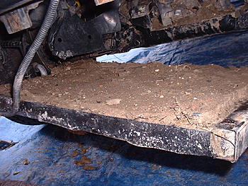

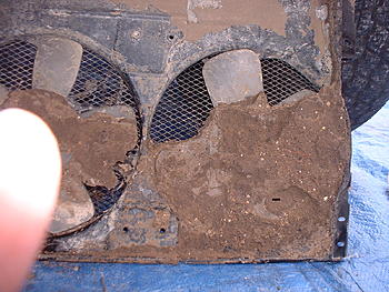

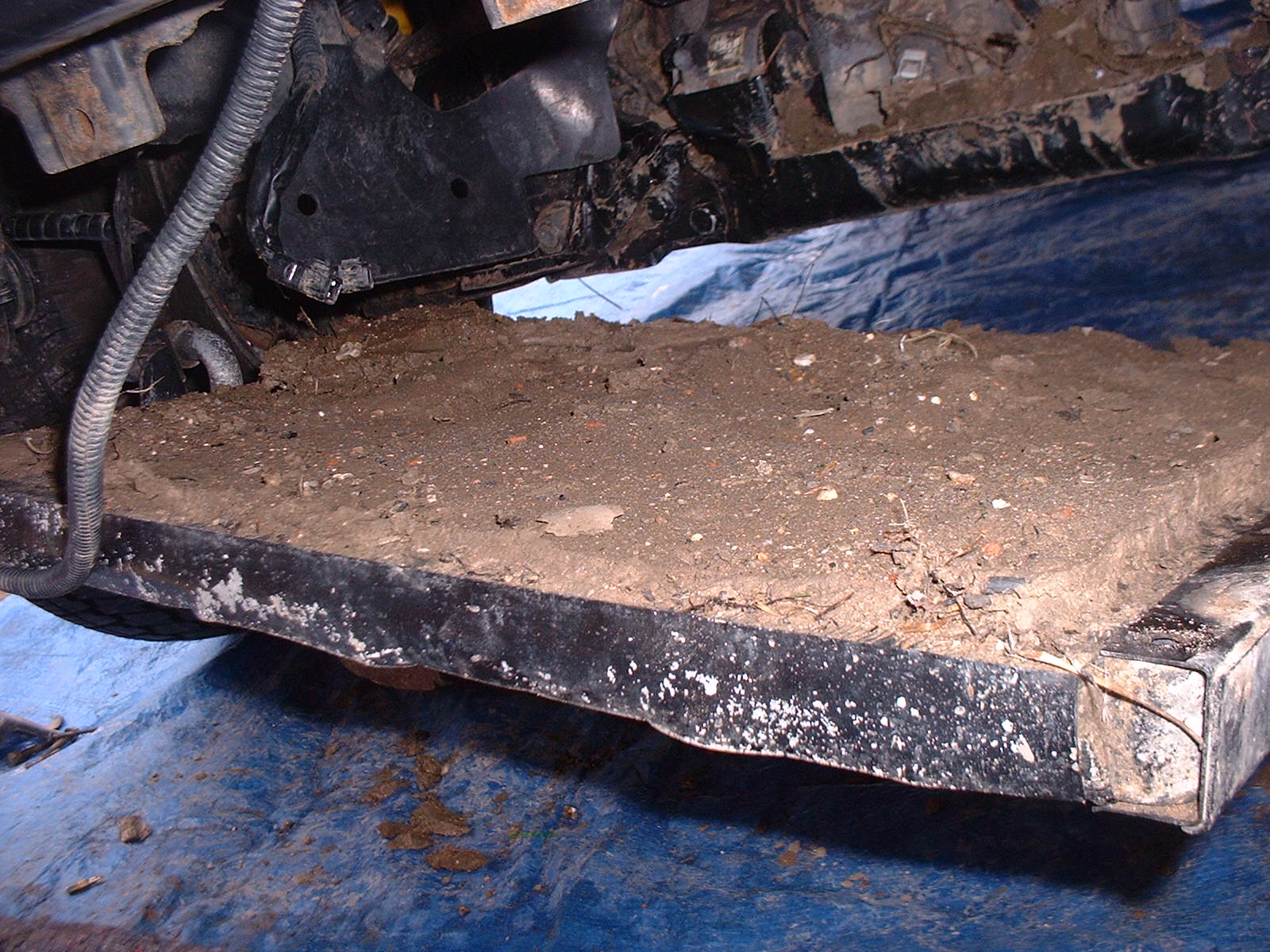

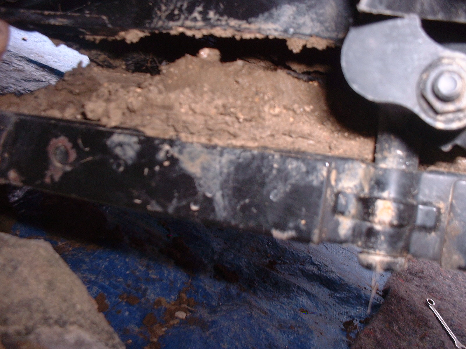

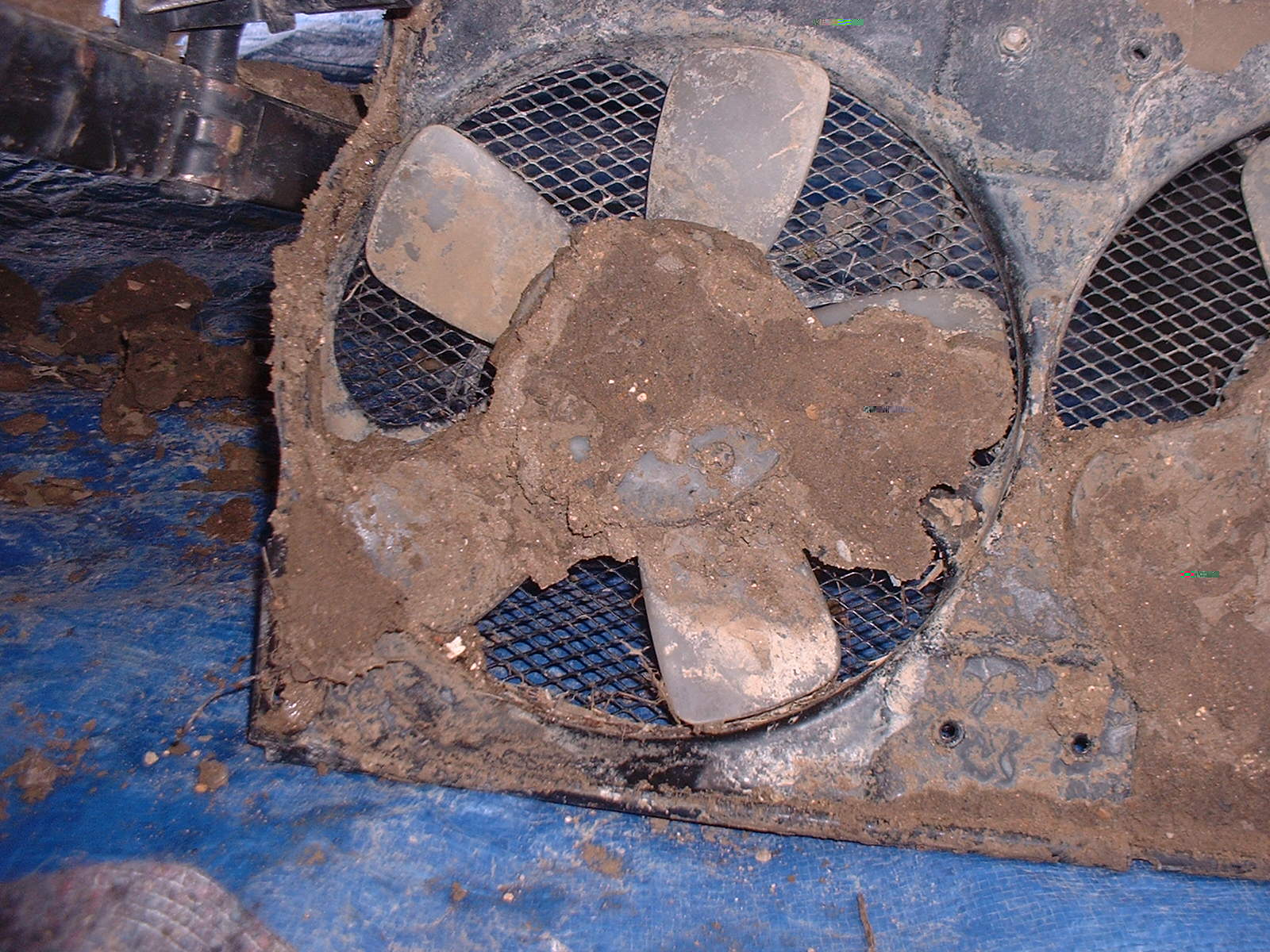

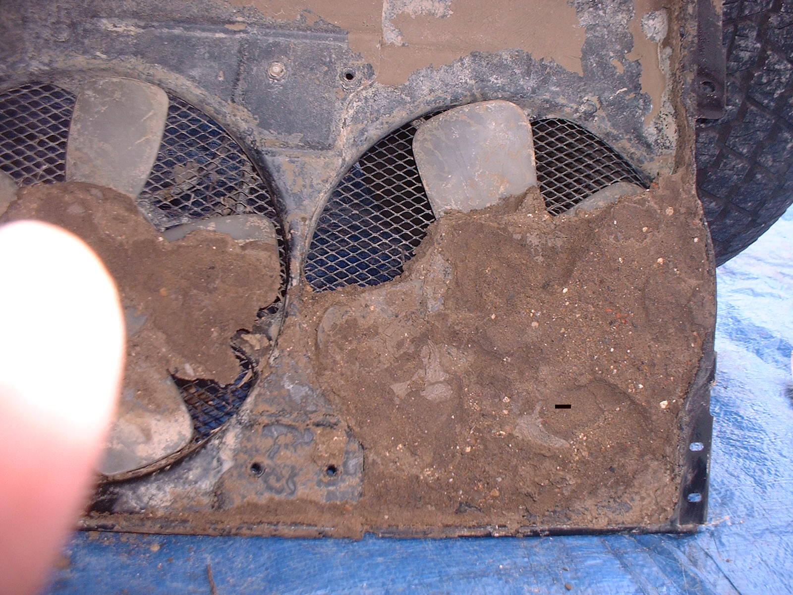

            Right peps
            The air con light comes on then after 10 seconds starts flashing.
            This is what was happening to me. I did ask but no one had any information.
            The aircon motor was engauging and kicking out after 10 seconds. (the light flashes).
            I droped the aircon rad and fans and this is what I found. The fan shroud was blocked solid along with the rad. It took me two and a half hours to clean it and free the fans. This was due to my not cleaning the aircon set up after off roading. It is not posible to just jet wash them from above successfully. There is no way out of the shroud for the mud/sluge.
            My aircon is now working again.
            Geoff
            Rubblebags (Geoff).
