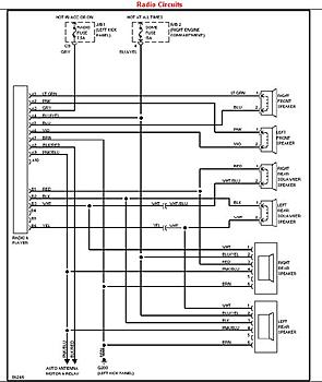

The previous owner (Japs) has cut the connector block from my stereo wiring.I have a Toyota to iso adaptor but all the diagrams i have seen so far do not match my surfs wiring colours,well not exactly. It is a 92 2.4 ssrx.I could really do with a photo or a correct wiring diagram.Any ideas anybody.

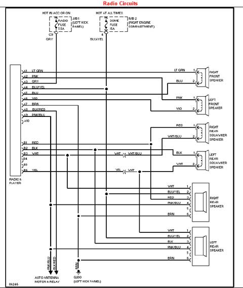

This any good to ya?Originally posted by throbberThe previous owner (Japs) has cut the connector block from my stereo wiring.I have a Toyota to iso adaptor but all the diagrams i have seen so far do not match my surfs wiring colours,well not exactly. It is a 92 2.4 ssrx.I could really do with a photo or a correct wiring diagram.Any ideas anybody.
