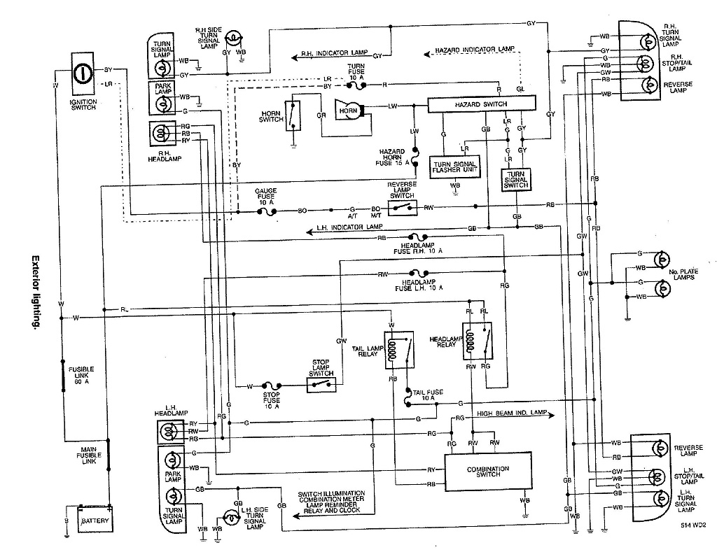

    i have a mk3 hilux, when i put the hazzards on only the right hand side lights light up the left doesn't, is there anyway to fix this without having to pay a fortune for a garage to do it, i need to know for an MOT soon. thanks...Kyle

    Not sure if the hazzards use a separate relay, if so it could be the relay breaking down.

      Do the indicators mis-behave...?
      The hazard switch is linked to both circuits... check the contacts on that...?
      Image may shed some light.... (escuse the pun)
