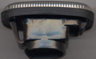

    how do i remove the small side indicators in the wing ????????

    Pretty sure they are twistlock fitting, i.e. if you turn them about 20 degrees they line up with cutouts and you can pull them free.

      Hiya KC, The side repeaters clip in, you will need something like a credit card to slip inbetween the light and the bodywork. you will find the clip could be at either end depending on which way they were clipped in.
        according to the handbook you lever them out from the rear of the indicator using some paper between the paintwork and indicator you use a flat bladed screwdriver thats what the book says i have not tried

            Hiya KC, this is the side repeater,you can see the push in clip on the left. indicator.jpg (8.4 KB)
              I used the forum search! Will be trying this later. Was a little puzzled how I could get around the rear of the indicator. So thanks.
