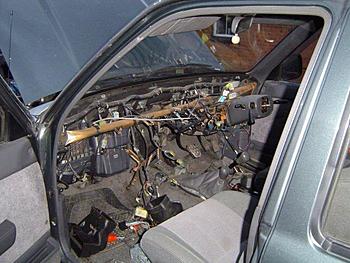

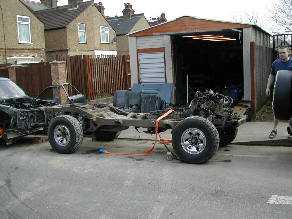

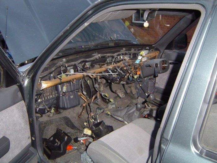

          there must be another way Tony
          I really really do not want to take out every single bit of dash...
          Tim
            Heres another way
