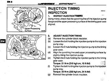

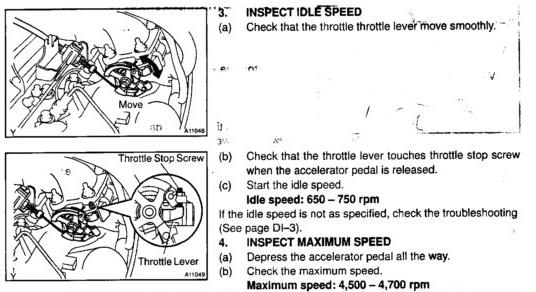

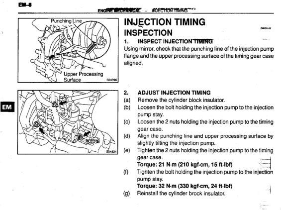

    i have a 3ltr td ssrx ltd 94 and it idles at approx 600 rpm what should it idle at and how do ajust idle

    The idle speed should be between 650 and 750rpm. It's not really adjustable as it's a function of the ECU. However see the attachments to check if the throttle cable is correctly adjusted and the injection timing. Also check the air filter as a dirty air filter can have an effect.

      thanks for that
