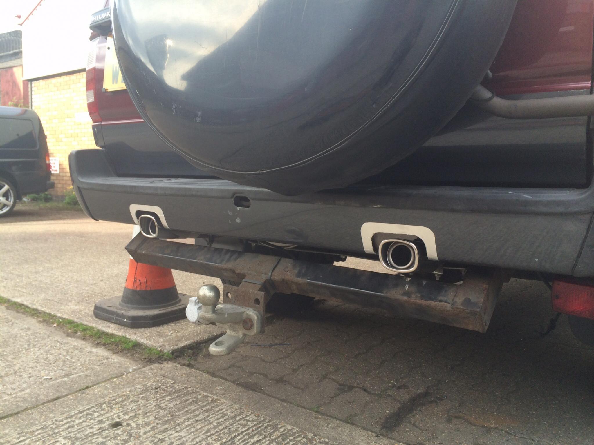

Another of the tank
Say hello to my little friend!
