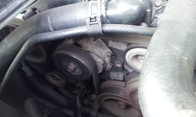

whats this bit?

Had engine ticking over tonight whilst doing some other things and noticed the tickover fluctuating ever so slightly. Theres 2 relays pulsing on nearside wing, traction solenoids they are labelled.
On the engine itself is what looks like an idler pulley but mounted on a pivot with what looks like timing marks. This was moving ever in time with the revs fluctuating. Picture attached if it helps. Its the pulley up and left from main crank pulley and timing.
Thanks.
If you need to ask questions like those, you really need to read up on the engine you're hoping to transplant.
Have a read here first........
http://www.lextreme.com/tech_maintenance.html
The pulley you're referring to is in one of the tutorials.
