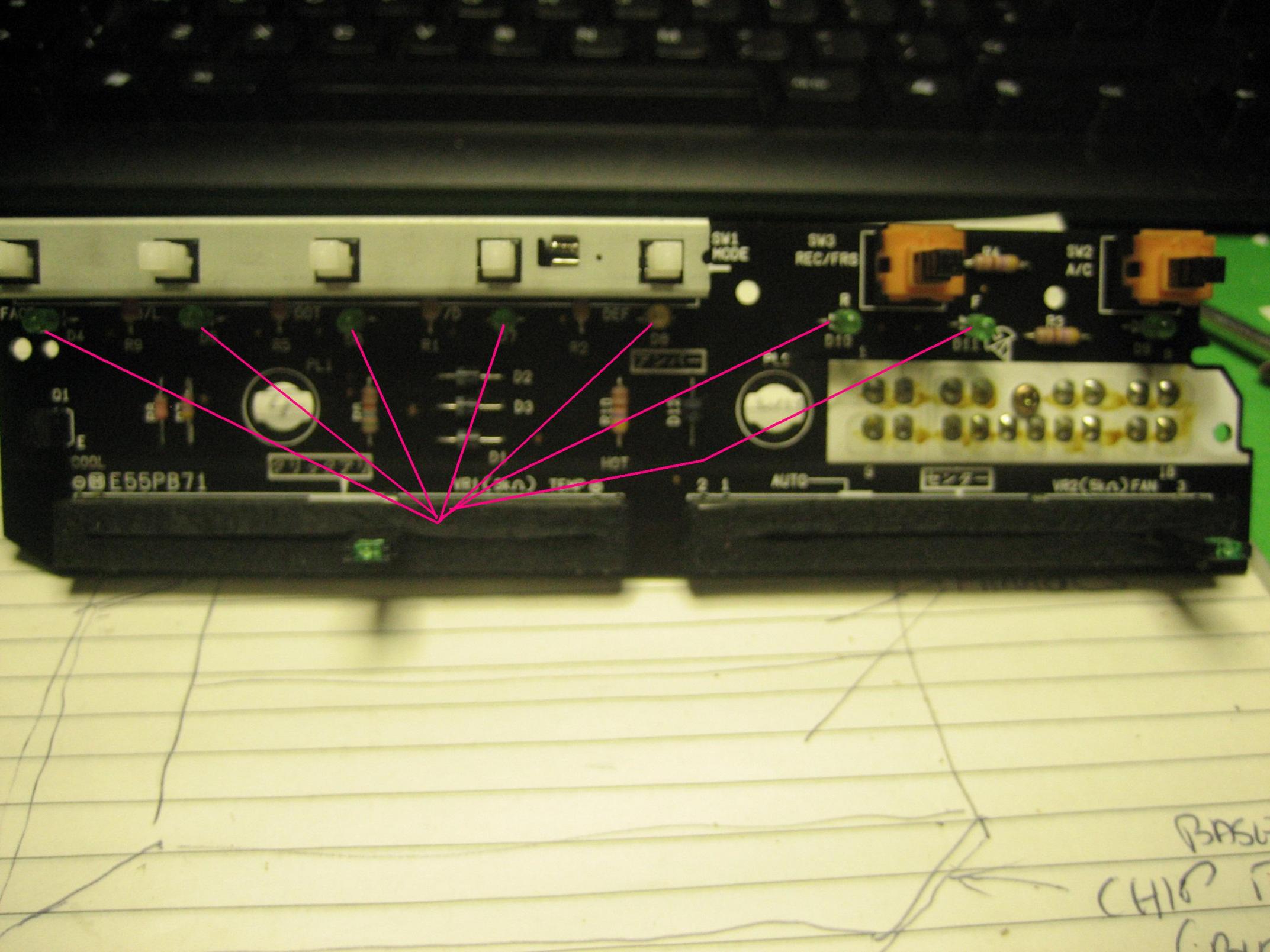

        • Hi mate, before i go ahead with this unit i thought i'd ask, you can see from the pic how the original lighting's fitted, basicly the same as the old but the main difference is there ire no clear plastic bits as in the 2nd ged units which take light to each indivuadal button, on the oldun's i always saw part of these plastic bits down and use them to hold/house the new led's, however on this unit the two original bulbs shine directly into the space behind the button symbols,
          this means i cant fit indivuadal color's behind each button! and match them to the "button in use" led, all i can do is try and fit several led's together pokeing through each hole (where the bulb fits), if i use different color's all you'll get is a mix of color to the button symbols, The "in use" original led's i can replace as i useually do but if i fit different color's to those they wont match the symbol colors,
          what i was thinking is this, if i light the main bit behind the buttons with one set of led's the same color, and replace the original "on" ones with the different colors, you can still see which button is in use but the symbols will all be the same color, sorry this sounds long winded and hope you get what i mean,
          if you woul;d prefer a certian color let me know, and as you say your in no rush and if you like i will give it a go and see what it looks like, post a pic for ya etc,
          the other thing is there are two square led's fitted in the slider ends which i cannot do anything about (unless i try stripping the switches which i dont feel comfortable doing as it aint my unit)
          cheer's ian
          BTW! sliders look real good, in fact this thread has to be the best on the site, well dont mate, (if i ever win big!!!!!)
          • Your idea seems best mate. I don't mind if is just the one colour. Green or white would be good as I've replaced the dash backlighting with bright white and all the auxillary switches have a green glow.
            Take as long as you like with it as it's your first 3rd gen version, make notes and wot-not. I suspect you'll get some future orders for them after I post photos of mine.
            Cheers.
            • OK me old mate! i'll stick a pic on as soon as, i was thinking green as well, they are a bit brighter than blue, to be honest at first glance this unit seems easier to do than the olduns, like i say tho i used the old clear bits to mount the led's but dont have this option with this one, it's certainly much easier to strip down,

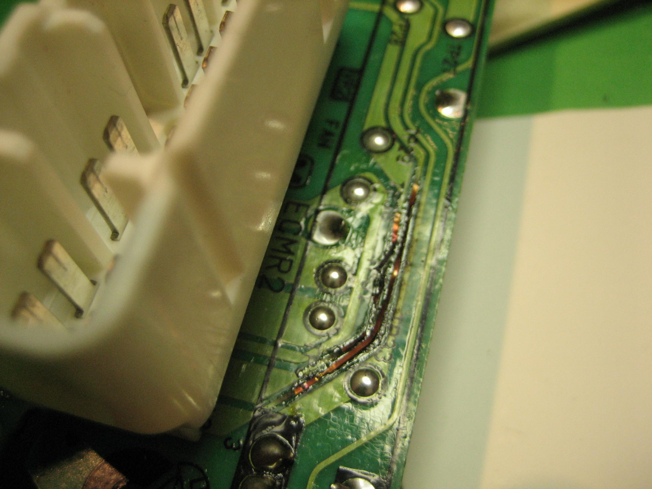

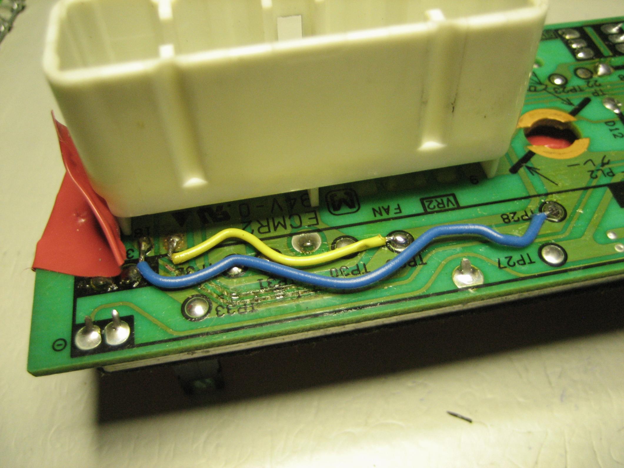

              • Hi vince, the burnt tracks in question
