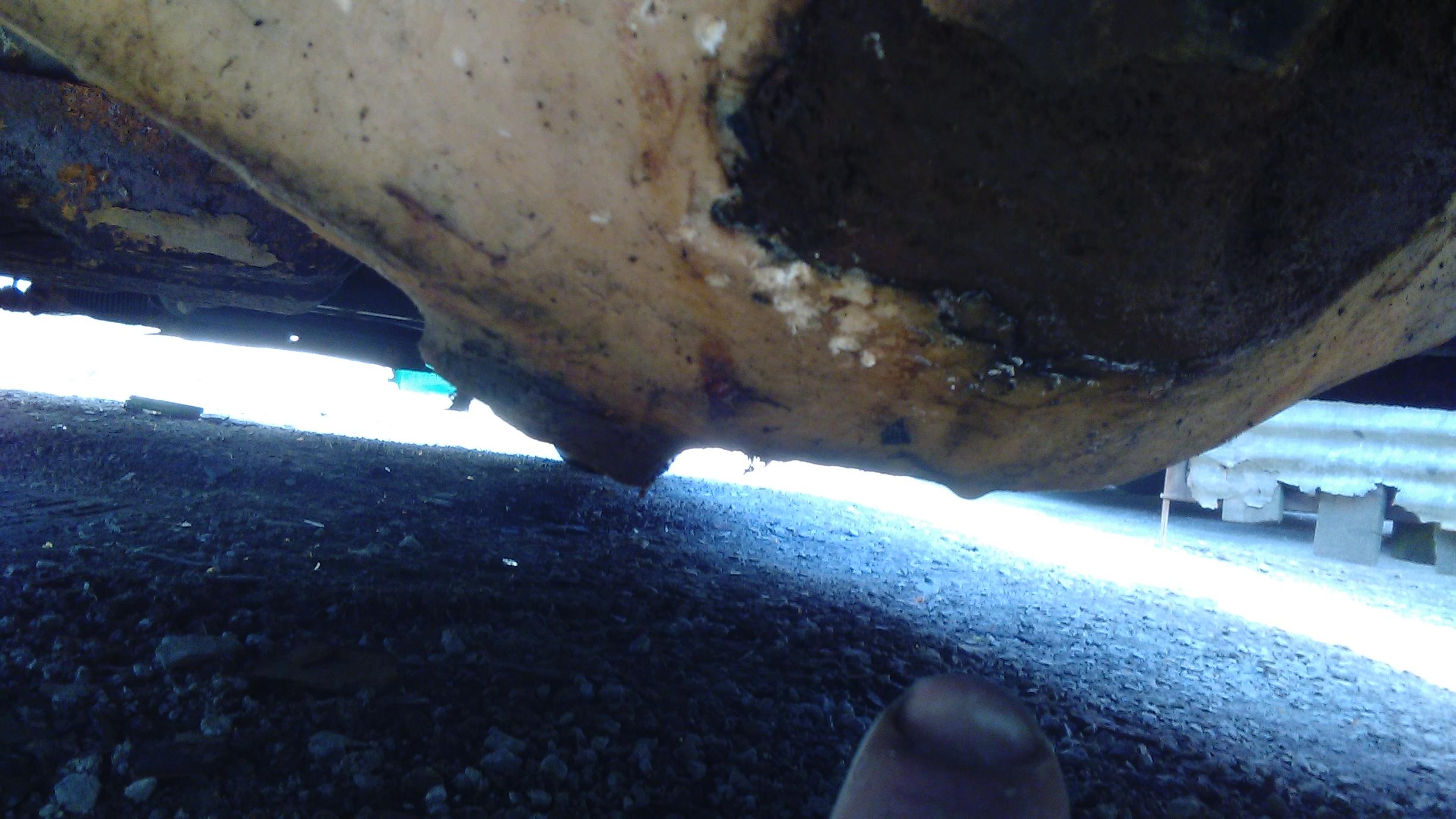

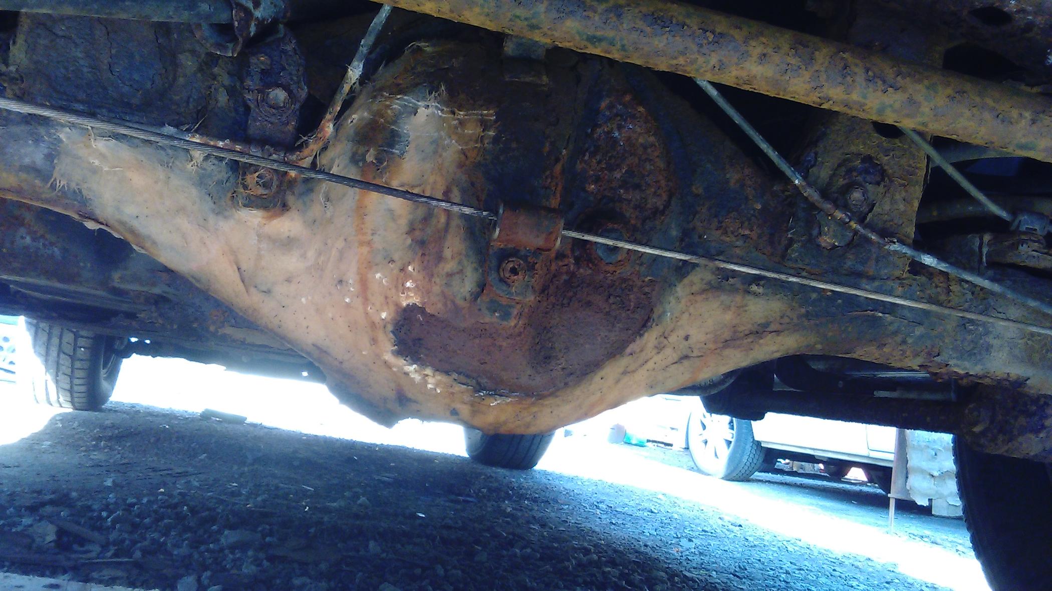

I have noticed a very small drip coming from my diff , when I got the surf it came with a replacement axle , is it a hard job to swap over axles or is there a way to seal the diff , which would be the easiest way , it looks like someone has tried to seal the diff by painting some sort of white sealer on it , just seems a lot of work changing axles because of a very small leak , what do you all think , thanks

You could always put your diff in the new casing if its different. you'll need a seal for it, and I'd assume a few new nuts and studs as it looks quite corroded.
