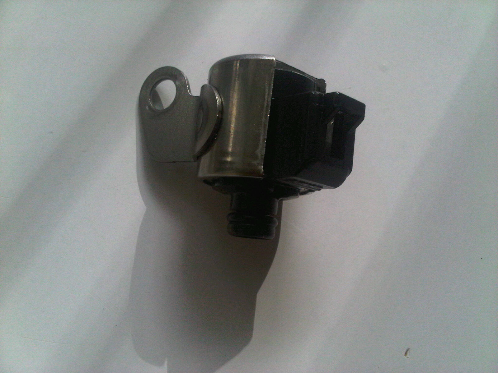

Part number is 85420-30200. However according to the Toyota database this has been superseded by part number 35250-50030, of which they had one in stock (pic attached). It's cylindrical while the old part was box-shaped.
It has a pin on one side and a mount on the other side.
Has anybody done this before? Is it just a matter of dropping the pan, removing the old one and plugging and bolting in the new one?
I have been looking online for pictures but not much luck.

Edit: Sorry, the picture is a bit crap...
