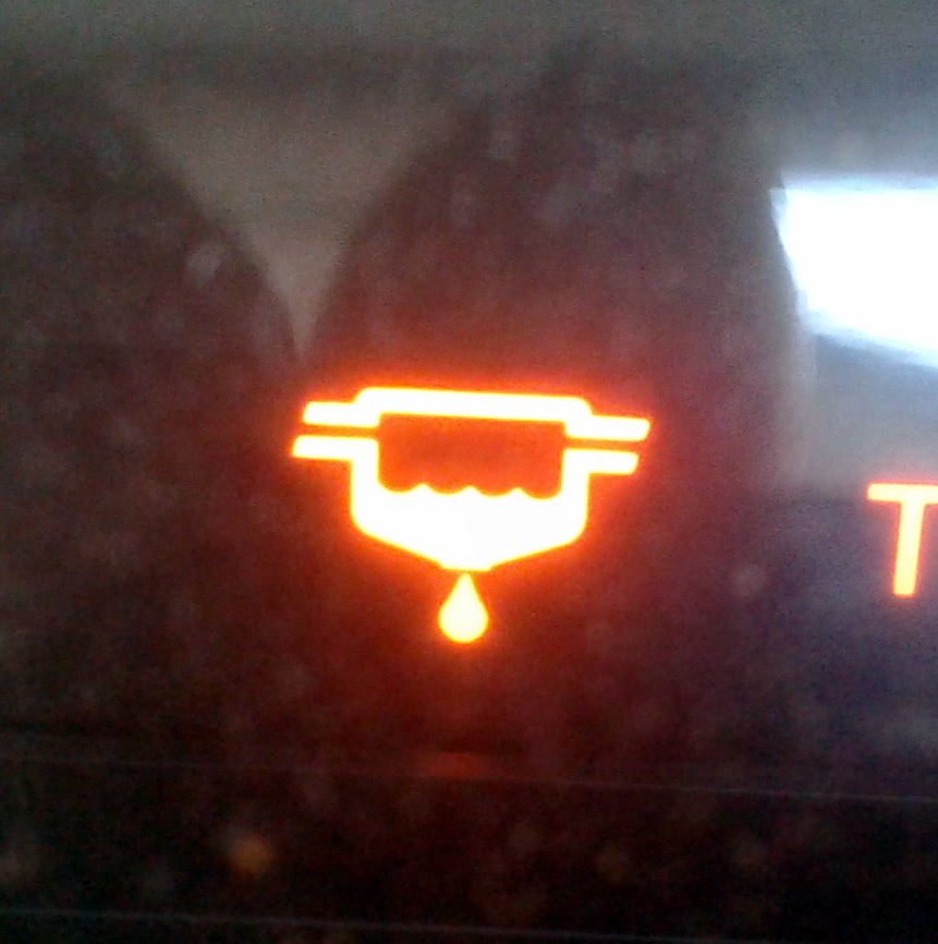

    Hi all. I have had this warning light come on on my 3.0L Gen 2 Surf. I thought it was gearbox oil, but have checked the level using the dip stick at the side of the engine, and all looks ok. Any ideas? (be kind, I am new to the 4x4 area)

    Fuel filter needs draining / replacing, there should be a plastic wing nut type screw underneath it with a couple of wires coming off it. Just unscrew this a little and excess fluid will start running out of the drain tube in the middle of it.
      To answer next question...........open the bonnet & its screwed to the bulk head on passenger side
        Oh yeah, forgot that bit of info, sorry
