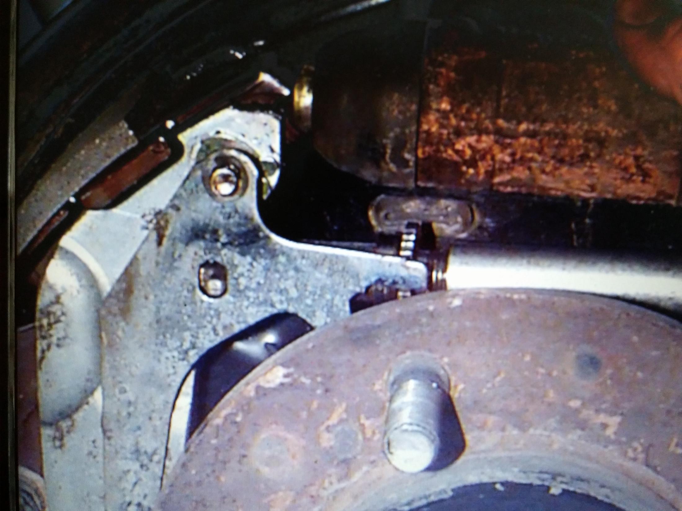

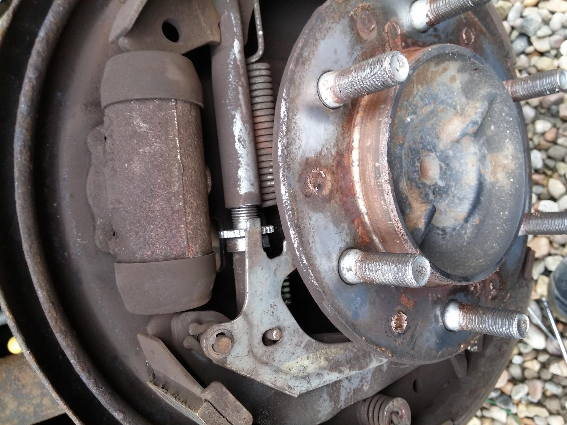

                    Many thanks for your thoughts and advice. I have gotten the bugger off! After having seen a photo of the ratchet mechanism I decided that rather than giving it big hammer on the drum a more serious effort was required to force back the metal bit that sits on the adjuster. What was surprising was the amount of force I had to apply to get the adjuster moving particularly as it had already started to slacken off. Attached 2 pics to show anyone with the same problem where the relevant bits are inside the drum - a great help when working hunched over in reverse though a slot in the back plate. Now I have the headache of fitting a new bearing.
