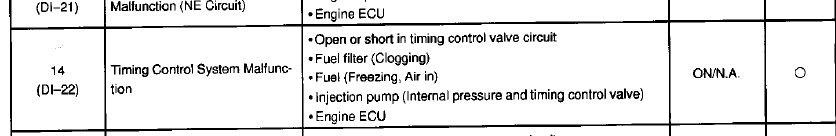

    On pause then four flashes (on off, on off, on off, on off)
    I don't know how to interpret this.
    I t is a1997 3rd gen knz185
    Thanks
    Thats code 14, Timer Control Valve. (SPV)
    No need to remove the pump to get the valve off.
    Try clearing the codes first by disconnecting the battery for 20 mins and see if the same code returns.

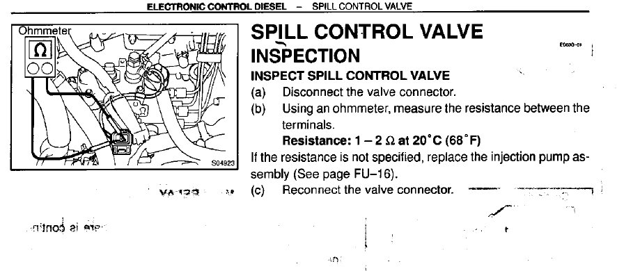

        Do you have a multi meter? Check the resistance across the pins at the SPV plug, it should be 10-14ohms.
          I do have a multimeter. I will check that now.
          Once again thanks.
            Just checked. It is reading 1.7 ohms
              I bought a spill control valve from a breakers. Just fitted it and still have the problem!!!!!
              Help getting desperate now.
                According to the manual that's ok.
                  Thanks. It was suggested earlier that it should be 10 to 14 ohms. I checked the ohms on the replacement and that is 1.8 ohms.
                  But my problem remains, it starts fine but won't rev past 1500 revs. Could it be something to do with the timing control valve?
                    The manual states that it could be one of several things. How anybody could guess it for you over the internet is beyond me
                    If you get hold of the toyota manual it will guide you through a full, very time consuming diagnostic of the whole engine.
                      There seems to be some confusion in this thread - the error code points to the timing control valve that should measure the 10 - 14 ohms that Bushwhacker stated, but you have swapped the spill control valve that should measure 1 - 2 ohms
                      hth.
                        hth.
                        Apologies its my confusion. I thought Bushwacker was talking about the spill control valve. I have checked the resistance on both now and they are within the accepted range. The timing control valve was 10 ohms and the spill control valve was 1.7 ohms.
