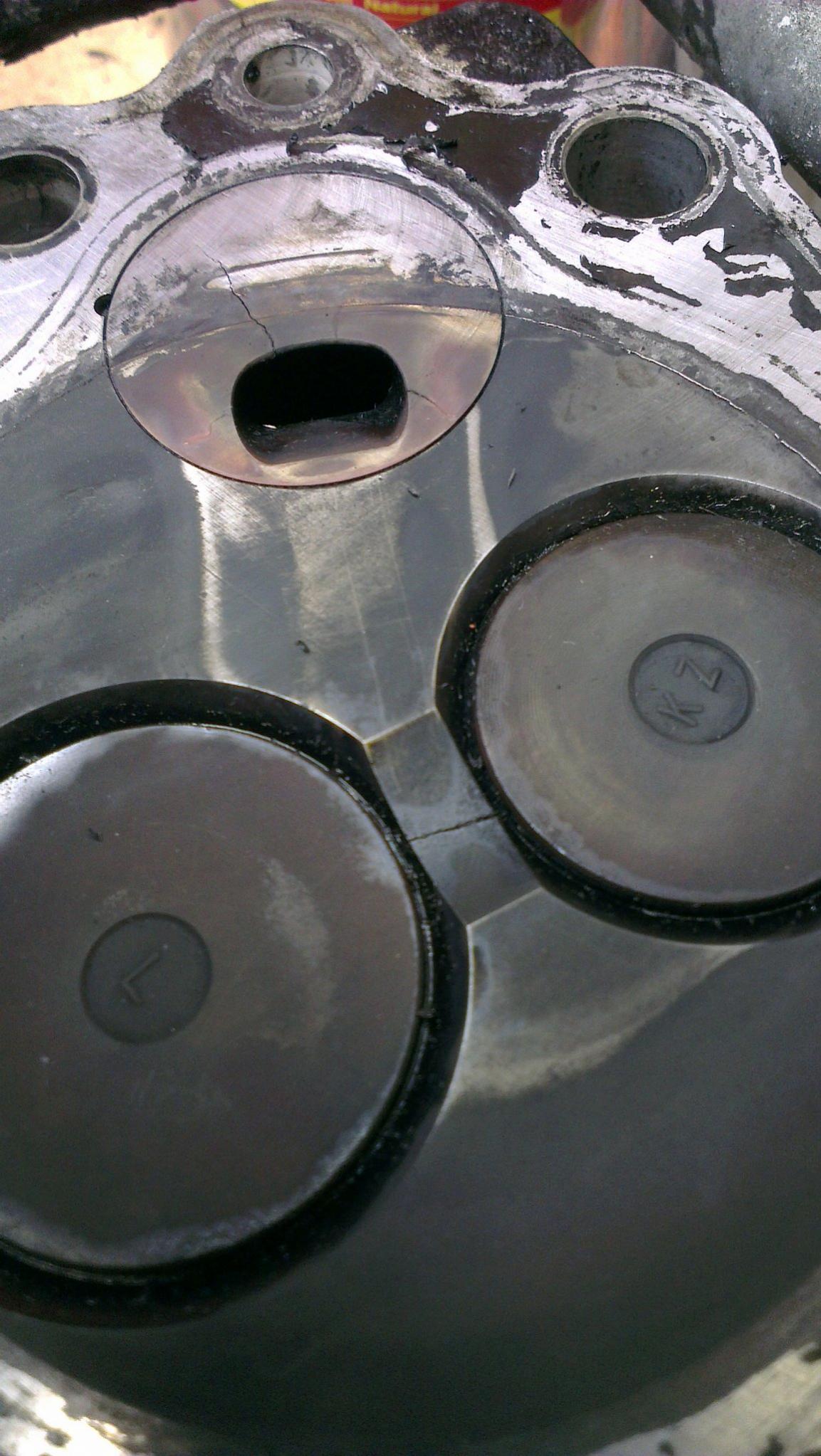

          16 cracks and counting!
          3 (at least) in every combustion chamber insert and one between the valves on EVERY cylinder.
          How the hell was it still running so well?

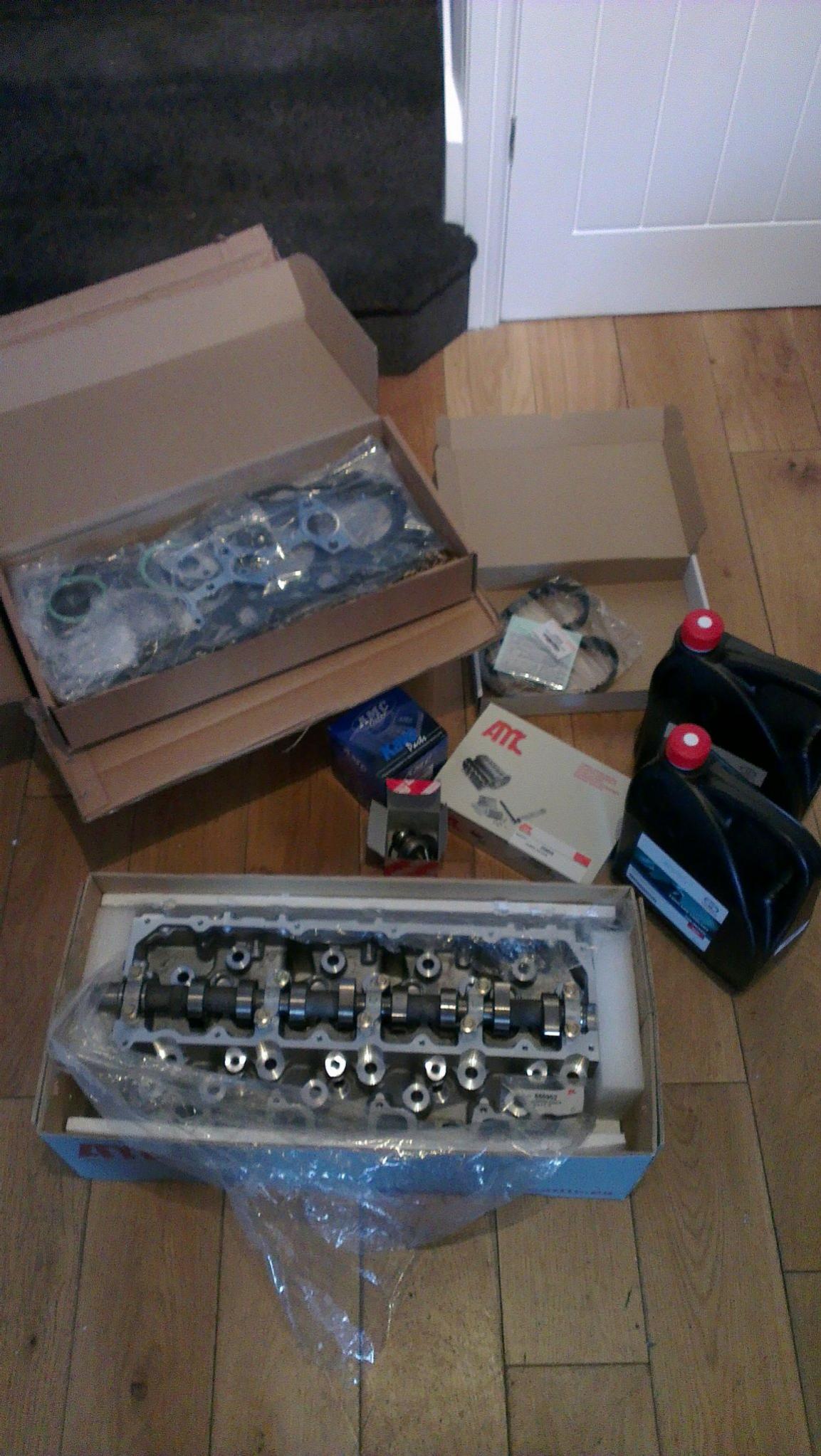

                    Here's what £900+ gets you from Roughtrax.
                      Not bad!
                      Do you know what caused the head to crack?
                        No idea really, I first noticed it coming back from LeMans in 2012 just loosing a bit of coolant over time, maybe a litre over 500 miles.
                        It started with a bit of white smoke and then ran fine after 20 seconds, it was still running well right up to me taking it apart!
                        There was no overheating, no over pressurizing or anything.
                        I knew it needed doing so finally stripped it down before this year's trip.
                        Hopefully it will all go back together well and have no further problems.
                          It's quite weird how these surf engines seem to just do that without anything obvious triggering it...anyway, good luck with your new RT head, they seem to be very good.
