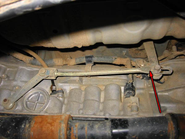

    The shift lever linkage under the floor probably needs adjusting.
    Look at the rod that goes from the shift lever arm to the position switch on the transmission and you'll see it has a slot on one end that allows for adjustment.
