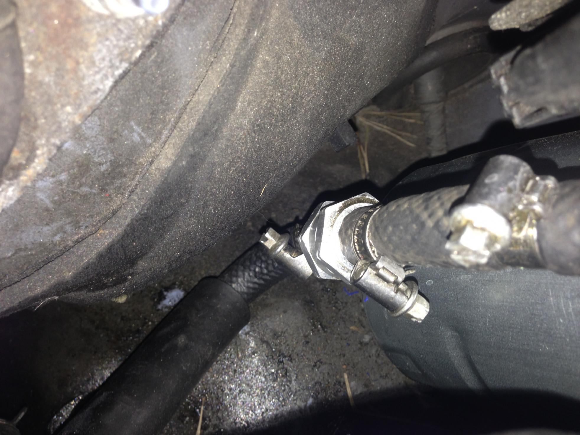

When the engine does eventually start the primer goes soft almost immediately. I have also attached a picture of the fuel line leading to the primer pump as i don't think all these connectors are right.

I have noticed a small hiss sound from the primer and if I pump it till its hard it does not stay hard for more than 10-20 seconds.
