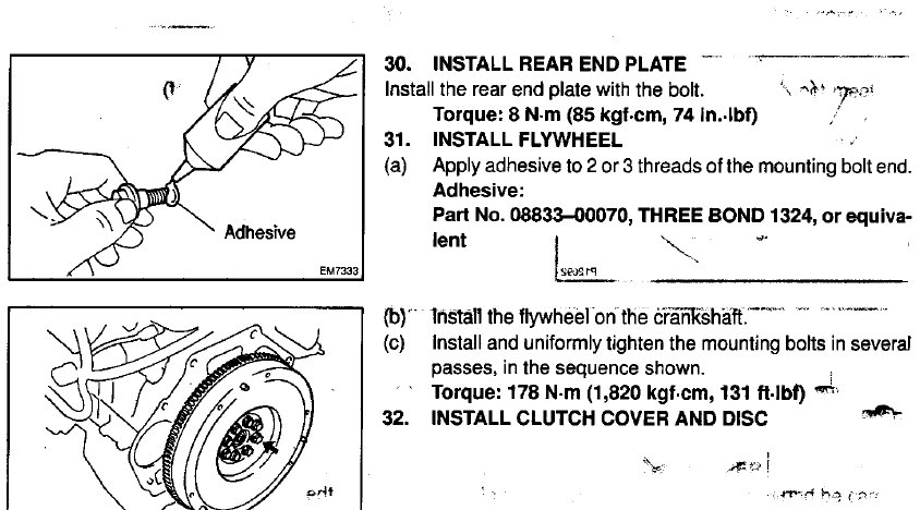

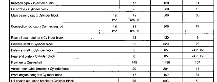

I need to swap my flexplate fom my old block to new one. Can't find the torque settings for the bolts.
My manual says 178Nm for a manual flywheel, but nothing about the autos.
Is it the same?
