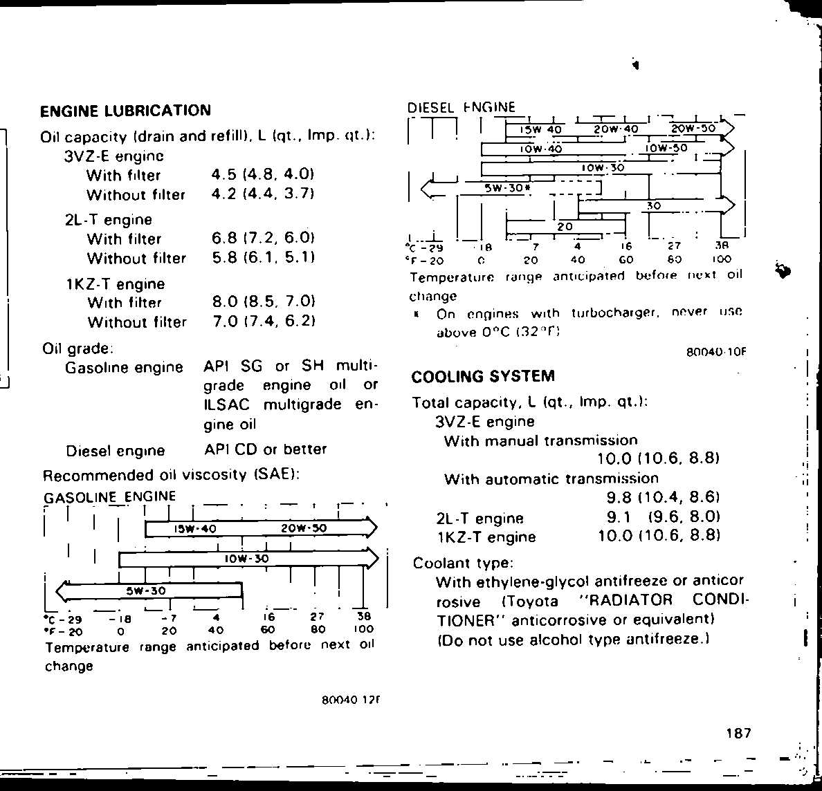

                              Toyota Engine Oil Capacities
                              Here are the Toyota engine oil capacities. I use Millers XFD 5w - 40 fully synthetic, 248,000 miles original engine. Head replaced 3years ago(rt), oil pressure at idle 25psi, at 2000 rpm 60psi +.
