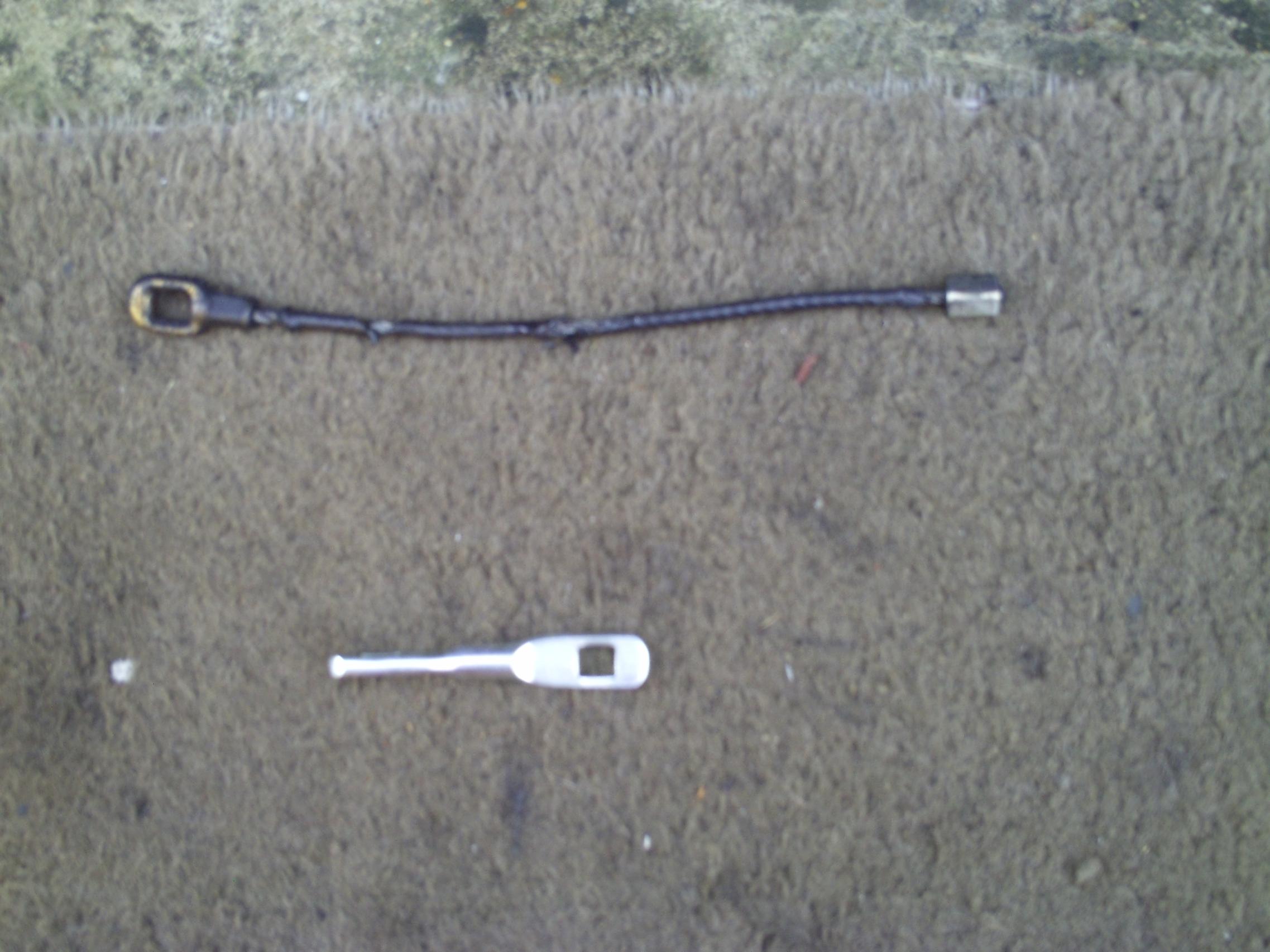

Our new baby has just been into garage for first service since we got her. Everything fine apart from a couple of wee repairs. The handbrake wire in rear brake drum has almost broken so going to replace that along with shoes. Question is that what milners is selling is different to what is on car. Apparently this is because Toyota has changed this part due to the wire always breaking. Our mechanic is concerned that the part from milners is shorter than the wire already in use and is worried this won't work properly. I have ordered the part anyway but does anyone have any advice as to this new part working ok to reassure mechanic.
Just an update to say my car is a 3.0TD SSRG 3rd Gen 1996.
