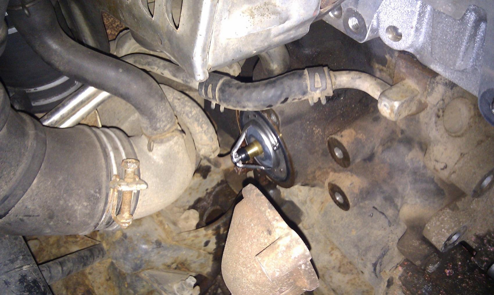

Under truck follow the water outlet on engine (cast pipe) and take out the wee 10mm bolt. At top of housing remove the 2 x 10mm bolts,(good time to flush system, take off the heater hose at the valve on bulkhead) put new stat in, refit heater hose.

Wee pic of stat location with aircon and alternator moved out of the way.
