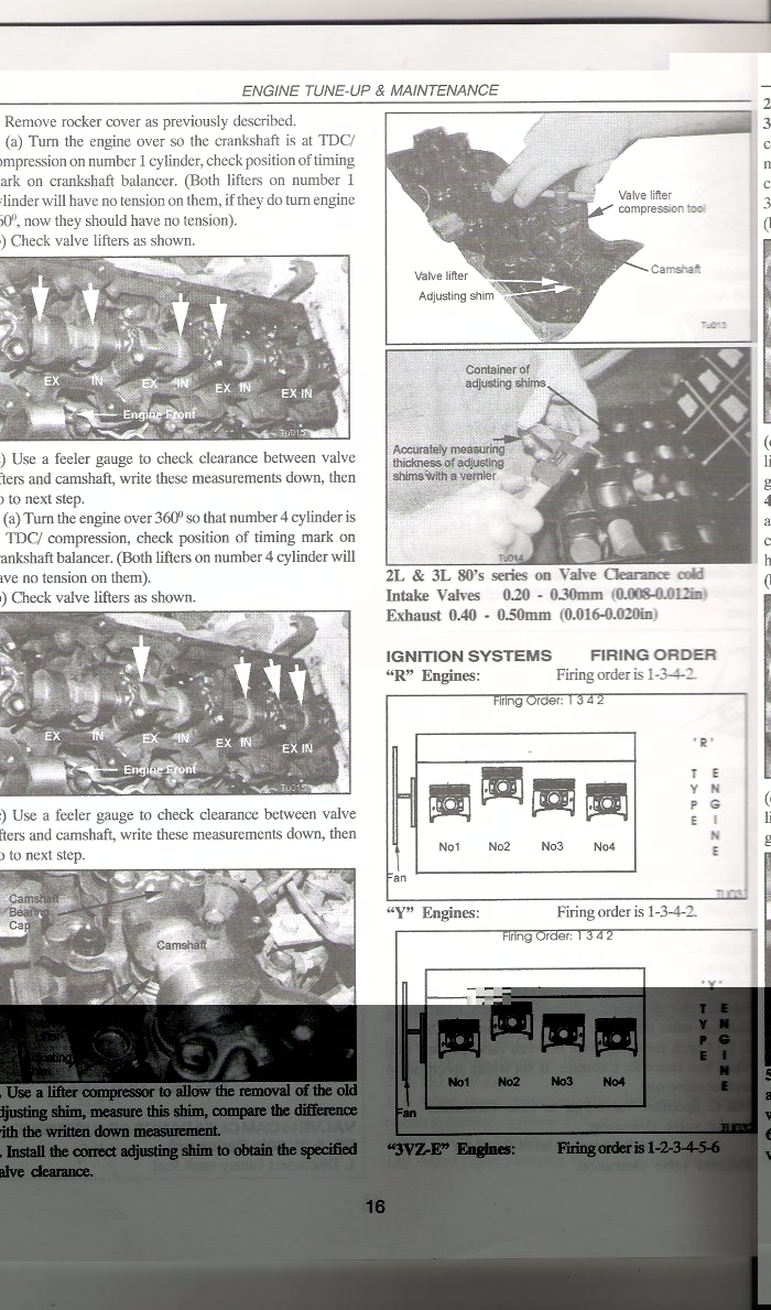

New too me with 200,000km on the clock.
Seems well maintained, new rear window motor, all good underneath, servicing done.
I would like to get the valve clearances checked (I have trustworthy pro friend used to 4runners, 70's and 73's) would you guys think that worth while?
Would it be best to check em myself then if needed let him pay for his tool?
How many hours I guess 2?
No smoke or rattles just used to bikes that go out at 60000km.
Found these when searching.
http://www.hiluxsurf.co.uk/attachmen...5&d=1076526529
Thx
